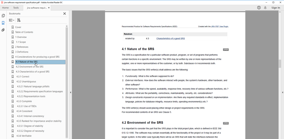

@Roberta Bortolotti To your "other plugin suggestion" ask:
Better PDF Exporter comes with a built-in template for requirements specification that generates PDF documents like this from Jira issues:
Give it a try and reach out to us if you have questions or would need to modify something!
(Please note that Better PDF Exporter is a supported and paid app, and I'm part of the team developing it.)
