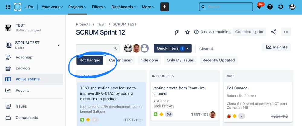

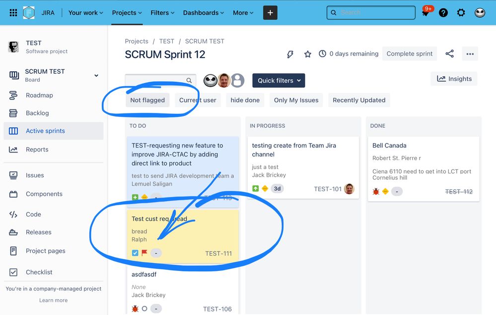

Hi Mario,
I just tested my instance using a CMP project and it worked fine.

With filter on
without filter applied
