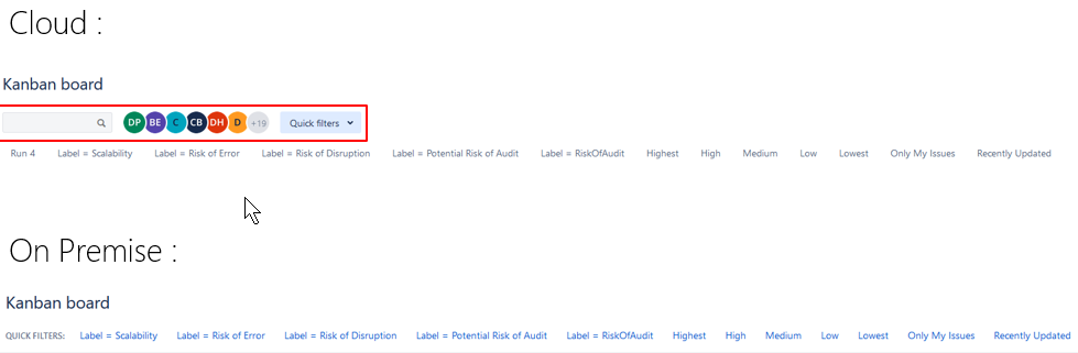

Hello all,
We have a customer that would like to migrate from cloud to server due to data security reasons.
While testing the Server version they noticed that the "Quick filter by assignee" is not present as it is on Cloud.
As you can see below the filter appears with the avatar of each user and if we click on it the filter will change.
Does anyone know how to activate the filter?
Thank you
Ivo

Hi @Ivo Rodrigues
In the board configuration, you can always add a quick filter with the query:
assignee=current user()
