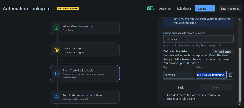

Basically when the field "Complexity" changes value (manually by a user), and the issue is unassigned, the lookup table will automatically grab all of the agent's tickets and then see if the weight is over a number, at which point they will be assigned a ticket or not.
Right now it's just in a testing phase right now so it'll just leave a comment-
In the lookup table I'm trying to get the number of tickets that a user has been assigned with the complexity of a specific value. So for instance, assigned to John Smith and then a complexity of "complex" as an int.
Once that's done I'll do math with it to calculate the weight of the tickets to see if the user can be assigned a ticket or not but right now I'm a bit stumped on how to grab the number of tickets with that field assigned to the user with the conditional expressions on the table as it seems like it only does true/false statements.

The values for your Lookup Table are incorrect: they cannot dynamically lookup work items (formerly called "issues") for a user when the table is created.  Instead...
To get the work items assigned to the person who triggered the rule, first use the Lookup Issues action with JQL.  For example:
  • trigger: value changes for Complexity
  • condition: Issue is unassigned
  • action: lookup issues, with JQL of the following.  Please adjust to meet your scenario.
    • assignee = {{initiator.accountId}} AND statusCategory != Done
Then create your lookup table to count the values in the Complexity field for that user's work items, using the match() function to find them and the size function to count the matches.
Assuming the field's smart value is "complexity" and it is single-select, this would work.
  • action: create lookup table
    • name: varIssueCountByComplexity
      • row
        • key: Complex
        • value: {{lookupIssues.complexity.value.match("(Complex)").size}}
      • row
        • key: Detailed
        • value: {{lookupIssues.complexity.value.match("(Detailed)").size}}
      • repeat for other values...
Finally, use the table to get the counts for the trigger's issues Complexity value:
{{varIssueCountByComplexity.get(triggerIssue.complexity.value)}}
