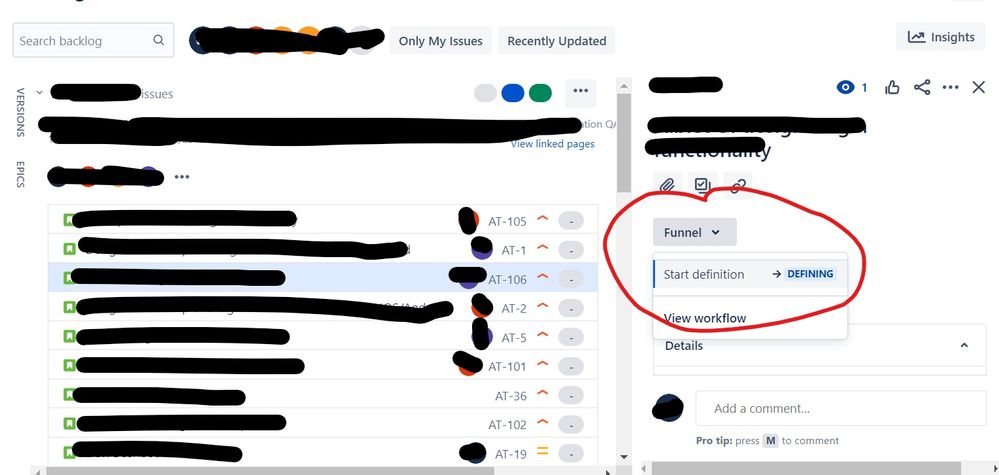

Can anyone tell me what permission I need to activate in order to have my team be able to change the status of an issue card? I have read through the permissions half-dozen times now, and can't figure it out.
I would like them to add the issue status, and be able to change it.
Image attached for clarity.

In the image you provided the user appears to be able to change the Status of the issue. They have only one status that they are allowed to select - Defining.
Is this screen not a representation from a user that is unable to change the Status of the issue? Or is the problem that they see only the one status value and not others?

I think you are correct when you say the user is unable to change the status of the issue, and they are unable to add more statuses to choose from.

1. In the Workflow the transitions may have been configured so that the only Status an issue can go to when it is in the Funnel status is Defining. There may be no other outgoing transitions for the Funnel status.
2. In the Workflow the transitions may have been configured to limit who can execute the transitions. There may be additional outgoing transitions from the Funnel status, but there may be Conditions on those transitions that prevent a given user from executing them. In that case they would not see those other transitions/statuses in the list of available transitions/statuses when looking at the issue.
You may not need to actually add more statuses to the workflow if one or both of the above apply. The workflow would just need to be edit to address the above concerns.
If the workflow needs to be edited to address the above and/or add more statuses, that can be done only by a Jira Admin. And end user can't do that. In special circumstances a Project Administrator might be able to do that, but it requires a Simplified workflow to be used, and not shared with any other projects, and some additional conditions.

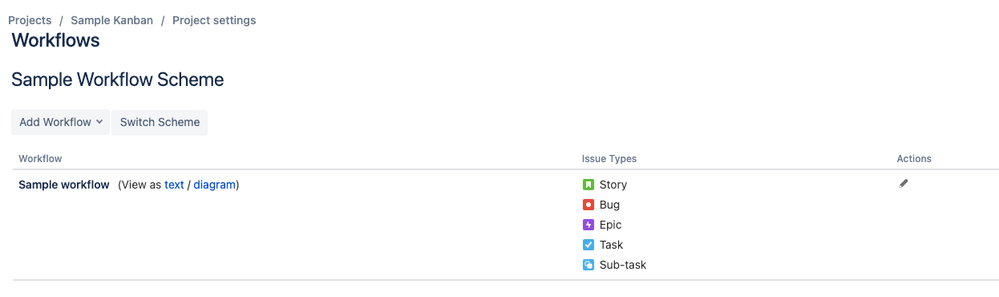

In this project go to Project Settings, then select Workflow. You will get a screen that shows the Workflow Scheme Name and the Workflows included in it and the issue types that use each Workflow. This is an example.
"Sample Workflow Scheme" is the workflow scheme name. It includes just one workflow named "Sample workflow". That workflow is used by all issue types in this project.
If you see something like this, that indicates the Workflow Scheme is shared by multiple projects. If you change the workflow then all the projects that share the scheme will be impacted.

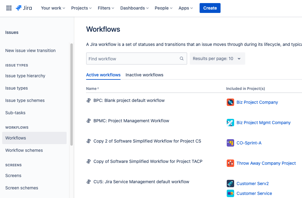

Even if you don't see that, it is still possible that the Workflow itself is in multiple Workflow Schemes, and other projects could be affected. To find out, you will want to go to the Workflow administration page. Click on the gear icon near your avatar in the upper right corner, then select Issues. In the new screen click on Workflows in the navigation pane on the left.
Search for the Workflow (not Workflow Scheme) name here. You will see if it is used by multiple projects and/or multiple workflow schemes in the table.
Example: The "CUS: Jira Service Management default workflow" is used by two projects.
