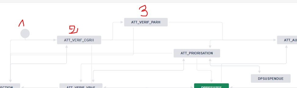

i write a script that is triggered when the issue is created. i want to transitionne the issue to status that is not the first status in the workflow (see inserted image). The first status in the workflow (after the beginning) is ATT_VERIF_CGRH but i want to transitionne the ticket to the ATT_VERIF_PARH status when a certain condition is verified.

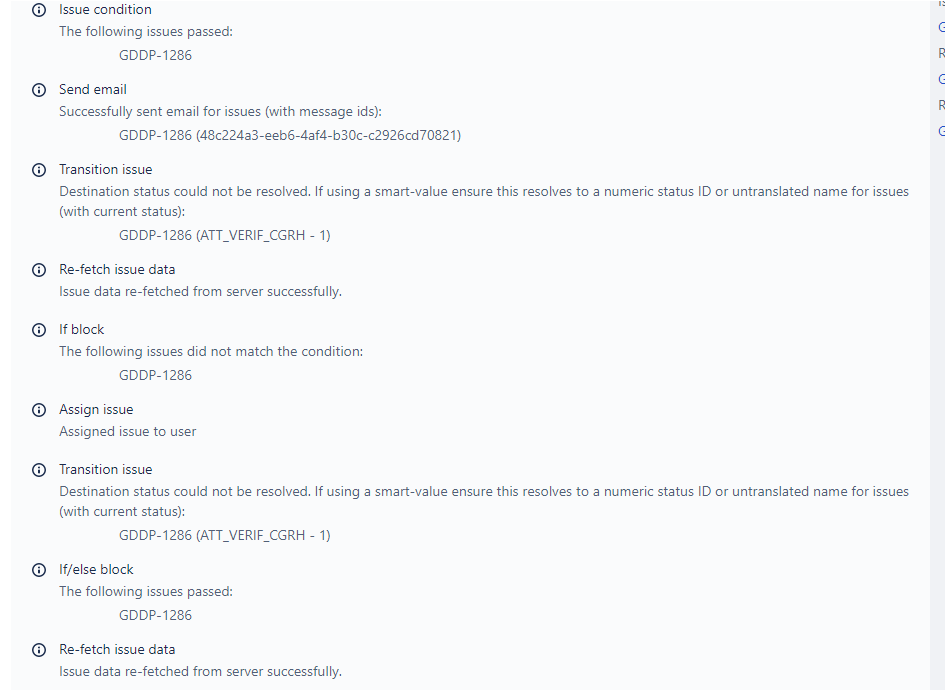

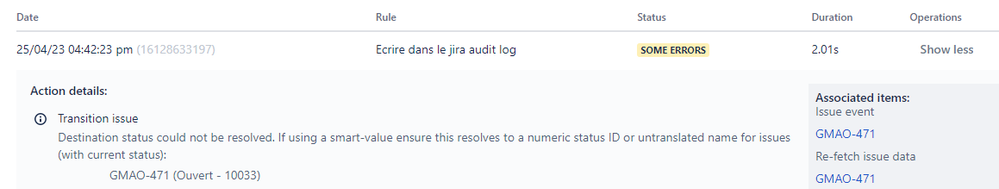

i get this message in the log and the ticket id tarnsitionned to ATT_VERIF_CGRH

this is my workflow:
is it possible to have a second transition from the begining (1) to ATT_VERIF_PARH status (3)  and resolve this error ?

Regarding your diagram, location 1 is not actually a status. It is just a visual indicator of the starting point in the status workflow.
Location 1 can have a transition to one and only one status. When the issue is initially created it will be set to the indicated status (2).
You can use your automation to then transition it to the next status (3), but you can't bypass status (2) based on how your workflow is constructed.

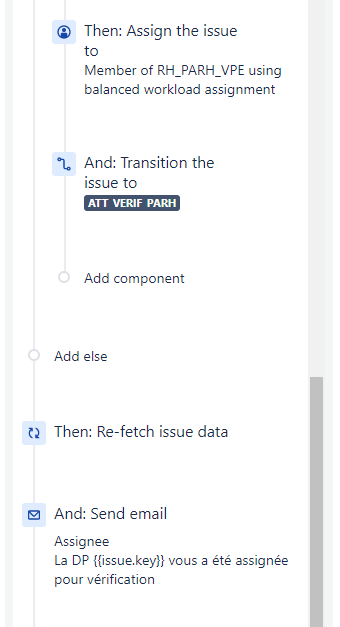

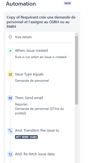

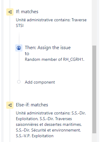

here the complete rule and error message

When an issue is initially created it is set to the first status in the workflow. The rule is executing after the issue creation is completed and the issues is already set to that first status.
You are getting the error that the issue can't transition to ATT_VERIF_CGRH because the issue is already in that status, and there is no transition to go from that status to that status.
You don't need to try to transition the issue to the first status as part of the rule. That is taken care of during the issue creation process. In your rule you only need to transition it to the next status - ATT_VERIF_PARH
