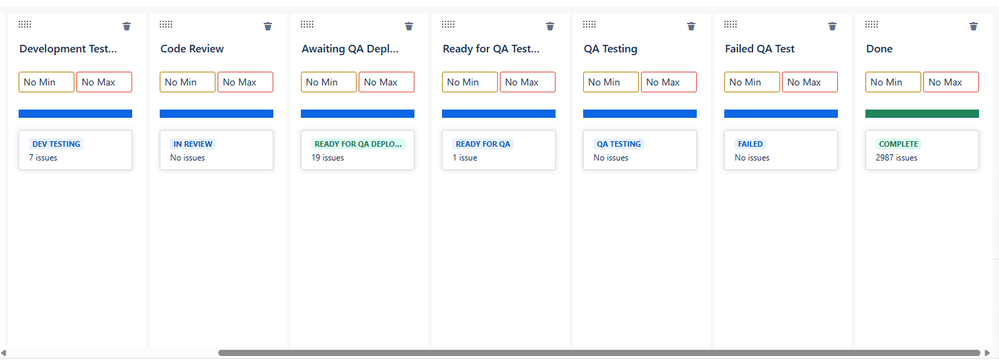

Screenshot here shows what my Kanban board looks like. I have 2 automation rules set in place when an Issue lands on the "Ready for QA Deployment" status in the "Awaiting QA Deployment" column.
1. Story Points get burned down to 0
2. Resolution changes to "Done."
Burning Story Points to 0 does help with the Burndown Chart report (red line on the graph goes downward when points are burned down to 0), however, the Velocity Report is still empty.
If I am understanding you correctly, you suggest that I do not have the points automatically burndown when an Issue lands in the "Awaiting QA Deployment" column, and to leave the points as is?
Furthermore, it sounds like I must somehow rework my workflow so that the "Awaiting QA Deployment" column is the furthest right column on the Kanban Board in order to get that correct Velocity Reporting.
Does this all sounds correct? Really appreciate your help here.

If you want your Velocity Chart to accurately represent the amount of completed work, don't ever change the Story Point value.
The way that the Velocity Chart works, as far as the Completed value is concerned, is that it adds up the estimate value (in your case, Story Points) of all of the work items in the far-right column.
So, if you want anything that has a status of Ready for QA Deployment to be included in the Completed portion of the Velocity Chart, that status has to be mapped to the far-right column of the board.
Note that you can have multiple statuses mapped to a single column, so you could have Ready for QA Deployment and Complete both mapped to the 'Done' column, which means that any work items in either of those statuses would have their Story Point totals added to the Completed total in the Velocity Chart.
That being said, unless I am mis-understanding your workflow, it would feel weird that it could be considered Complete while in the Ready for QA Deployment status but then later be considered incomplete when it moves forward in the workflow (to either Ready for QA, QA Testing, or Failed). But that's not directly related to this particular discussion.

THANK YOU very much for this info! I since tested everything you mentioned in a test environment, and the Velocity Chart reporting looks excellent.
I was not aware of the details you mentioned such as the importance of the "Done" tickets being in the furthest right-side column of the Scrum Board, as well as it being bad practice to manually burn down Story Points. These methods are how I have learned to handle Sprints while on the job, so clearly I need to take a lesson in Jira administration.
