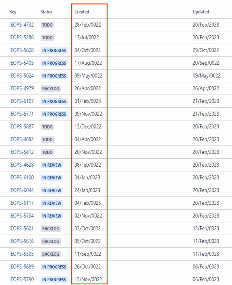

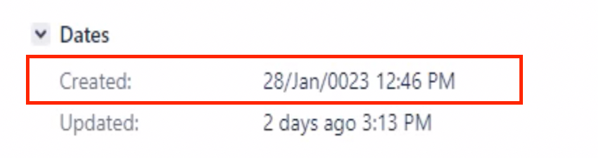

Only 1 project among several other projects we have on our site shows a queer created date format, as shown in the attached.
Cannot be fixed from "Look and Feel" as doing that would change the created date format for all other projects on our site.
Moreover, created date is a system field, so cannot even see it on any screen.
What could be the reason for this anomaly and how can we fix itScreenshot 2023-02-22 at 3.56.46 PM.pngScreenshot 2023-02-22 at 4.04.22 PM.png?

If the issue was not created through a third-party integration or via the Jira API, and the date format settings in Jira are correct and consistent, then it's possible that the issue was created or modified using an incorrect system clock or date/time settings on the device that was used.
If the system clock on the device is set incorrectly, this can result in incorrect timestamps being recorded when an issue is created or updated in Jira. This can cause issues to be displayed with incorrect created and updated dates, as in the case where the created date of an issue in Jira Software shows the year as 0023 while the updated date shows 2023.

We realized that the issue has been caused due to incorrect date format chosen while importing some data in Jan-2023.
That basically messed up the format of Created date field for all data till 1-Feb-2023.
All tickets created post 1Feb2023 show correct date format.
We are now updating the date format for past data from backend.
