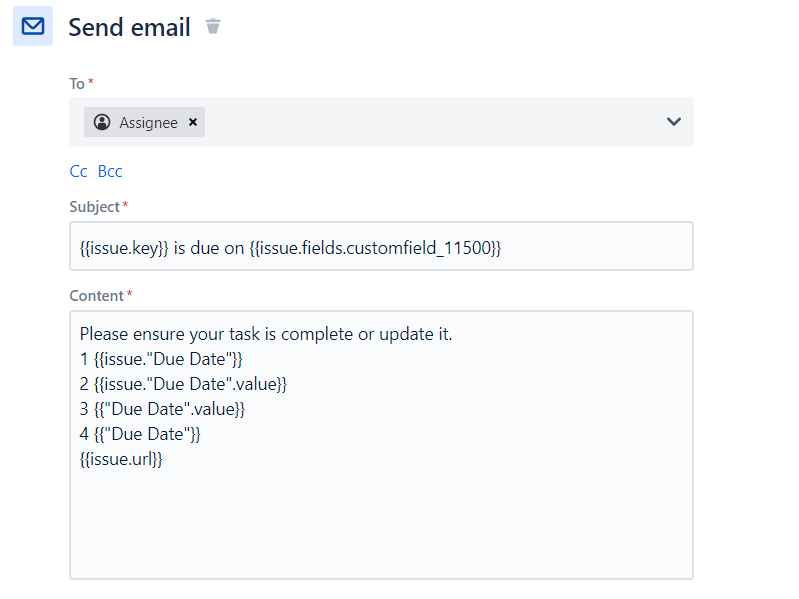

@Bill Sheboy I tried several "Due Date" syntaxes and they were all blank.
@John Funk  see below

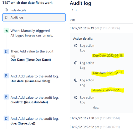

I just did a quick test in a Company-managed Project, and here were my results:
That last one has stopped working in rules but I believe still works in JQL and the REST API.

Can you share a screenshot of your rule that shows the details of the email?
