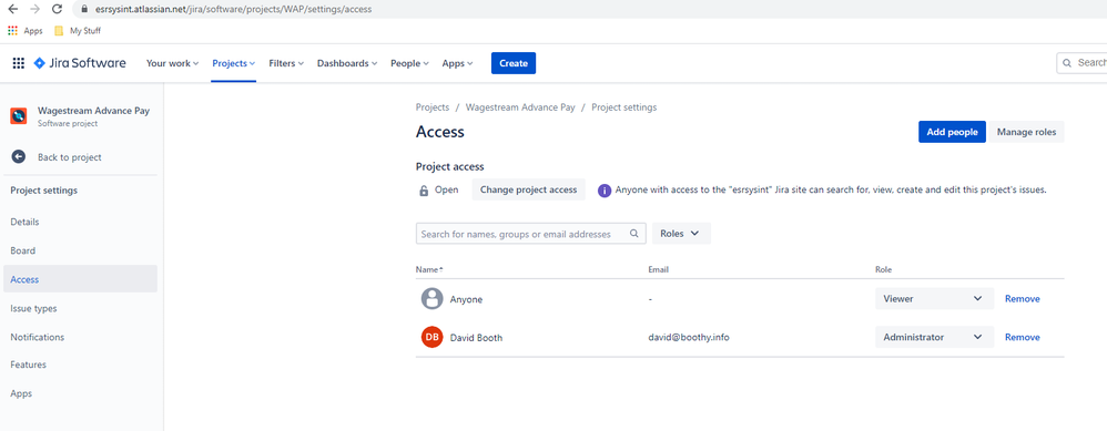

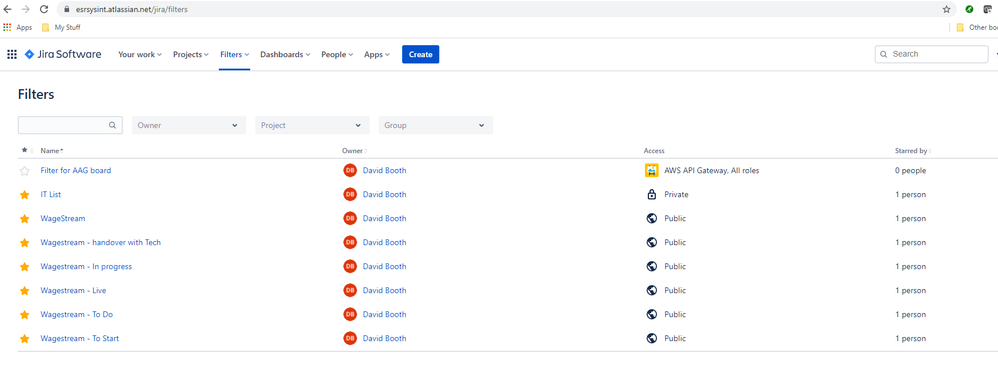

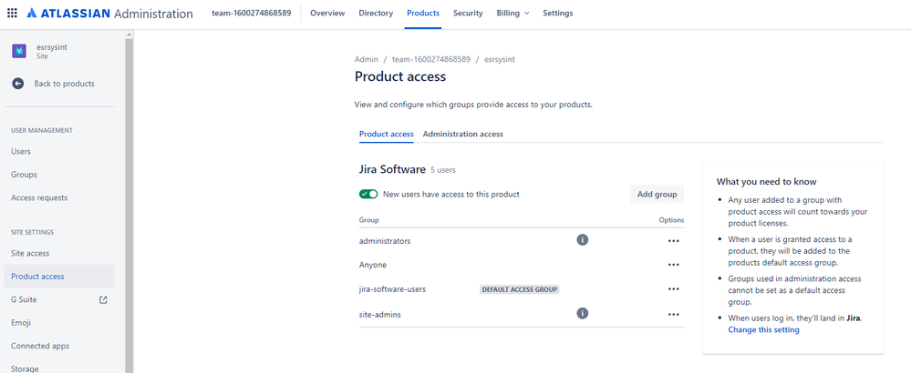

Thanks again for your response. I did what you suggested and I am still stuck.
I am sure I must be missing something simple, so I am sorry to be a pain, but if you have time, could you have another look and let me know what I have missed?
Where I am now is
- the Dashboatd and Filters are public.
- the project has permissions set to Anyone
- the product has permissions to Anyone
Dashboard-Permissions.pngfilter-permissions.pngproduct-permissions.pngproject-permissions.png

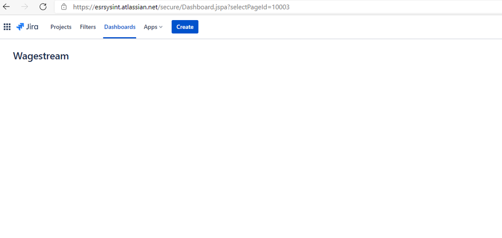

David Booth
August 3, 2021
Nic Brough -Adaptavist-
August 4, 2021
What gadgets have you got on the dashboard?
I'm guessing there are some reports on there using filters, probably the shared ones you've got named "wagestream ..." - those filters are probably invalid for some reason (such as the public user not being able to see the project, and hence issues, they should return)
Try visiting the filters section and seeing what happens when you use the filters - I'm expecting it to say project and/or field not valid for the public user, because they do not have the project permission to see them (be interesting to see if you, as a logged in user, gets different errors or working filters)
