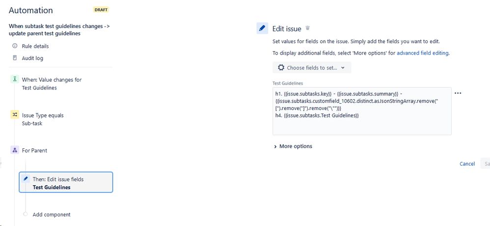

Hi @Mark Segall thanks for the response. Here is what my rule looks like

So if you're only looking to capture information on the sub-task that triggered this issue, you'd change up your smart values to look like this:
h1. {{triggerIssue.key}} - {{triggerIssue.summary}} - {{triggerIssue.status update}}
h4. {{triggerIssue.test guidelines}}

You should be able to do something like this:
{{#}}{{issue.subtasks}}
h1.{{key}} - {{summary}} - {{customfield_10602.distinct.AsJsonArray.remove("[").remove("]").remove("\")}}
h4.{{test guidelines}}

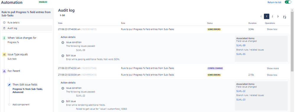

I am trying to do the same with a custom Select List (single choice) field (id=10083) from the sub-tasks into a custom Text Field (single line) on the parent task/story (along with the sub-task issue key & summary).
When I try the following for the Edit issue field component for the parent within the automation rule,
{{#issue.subtasks}}
h4.{{"value": customfield_10083}}

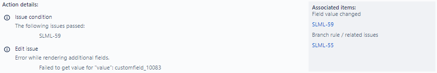

it produces the following error.
Any help on this would be much appreciated!

Thank you for the super prompt response! It looks like I'm getting a different kind of error ("Error while parsing additional fields. Not valid JSON.") with the above-mentioned edit.
I am very new to automation, so I'm wondering if I've made a fundamental misstep somewhere...JSONErrorforAutomationRule.png
