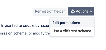

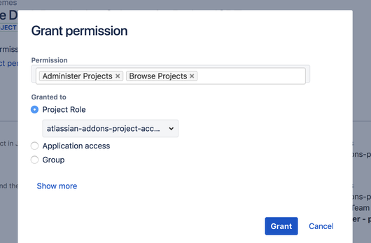

For the projects you migrated from your Server instance, it's possible the atlassian-addons-project-access project role is missing from the Browse and Administer project permissions. Here's how to resolve that:

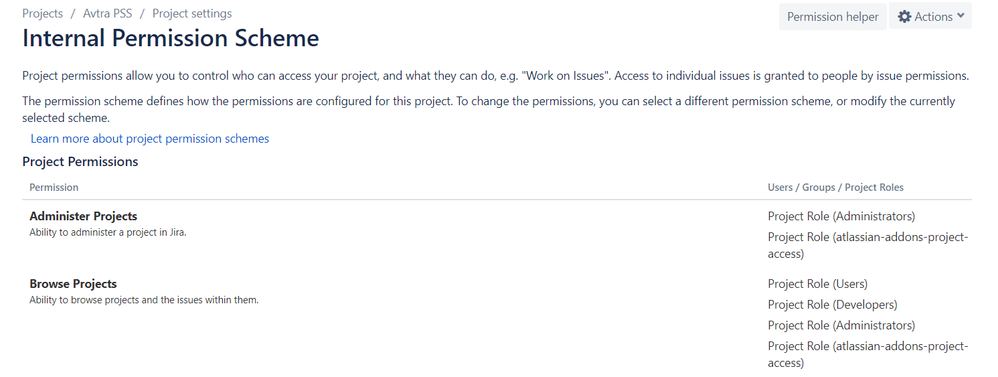

Further, with regards to the solution you have given, atlassian-addons-project-access project role has been already assigned for the Browse and Administer project permissions as shown in the image below. Still we had the issue which indicates the problem is not with the assignment of project role.
We tried out every possible way to resolve this. We changed the permission scheme same as a new project we created and still the old projects have the issue. Kindly look into this and provide us with a solution to successfully integrate the Slack with old projects.
