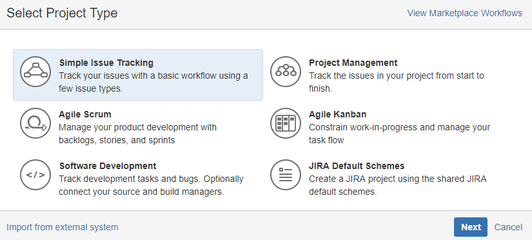

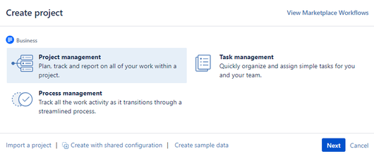

The latest issue is when trying to create a new Project:
- First at all, the project types are now different: We are given choice only to create Business projects whereas in v6.4.13 we had Software projects (please check screenshots)

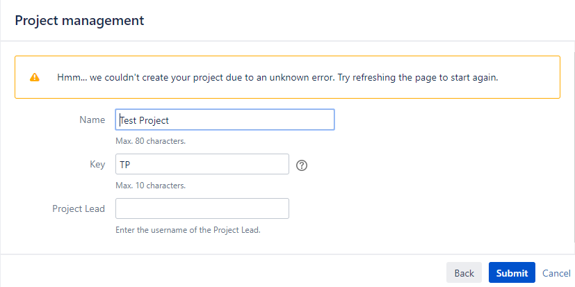

- When we try to create a new project, we get an error (please check screenshots) and the following line on the logs:
[c.a.jira.permission.DefaultPermissionSchemeManager] No permission scheme is associated with project 'Test Project'
The project is created but there is no permission scheme assigned to it, so it cannot be viewed to anyone.

Hi @Ahmed Ben Abid
from Jira version 7, the Agile add-on has disappeared and is replaced by Jira Software (it's basically Jira Core + Agile add-on bundled together).
I'm guessing you had the Agile plugin before, so in order to get back all your features you need to deploy Jira Software and not Jira Core.
This document explains the upgrade path and could be useful to you.

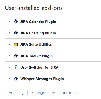

I installed the same add-ons we have on v6.4.13, I don't think we used Agile plug-in before. I will try JIRA Software
These are the add-ons:
Thank you,
Best regards.
Alexis Robert
August 11, 2018
Hi @Ahmed Ben Abid
from the screenshot in your first post, I noticed you have "Agile Scrum" as a project type, so you definitely have the Agile plugin in Jira 6.4 :)
You should check the add-ons page and select "All add-ons" instead of "User-installed", I'm pretty sure you will find it.
--Alexis

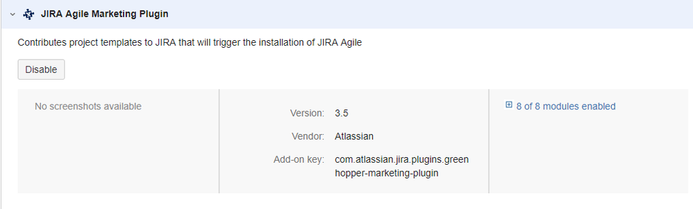

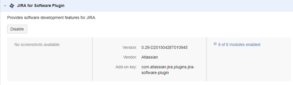

Hello again,
Thank you for noticing.
I displayed all installed add-ons and I found JIRA Agile Marketing Plugin in System add-ons which help with JIRA Agile installation.
In the other hand, I found another add-on named JIRA for Software Plugin which isn't present in JIRA Core 7.11.1, maybe this is the one :)
Thank you
Best regards
Alexis Robert
August 11, 2018
Hi,
indeed, it does confirm that you need to install Jira Software instead of Jira Core to get all those features back.
