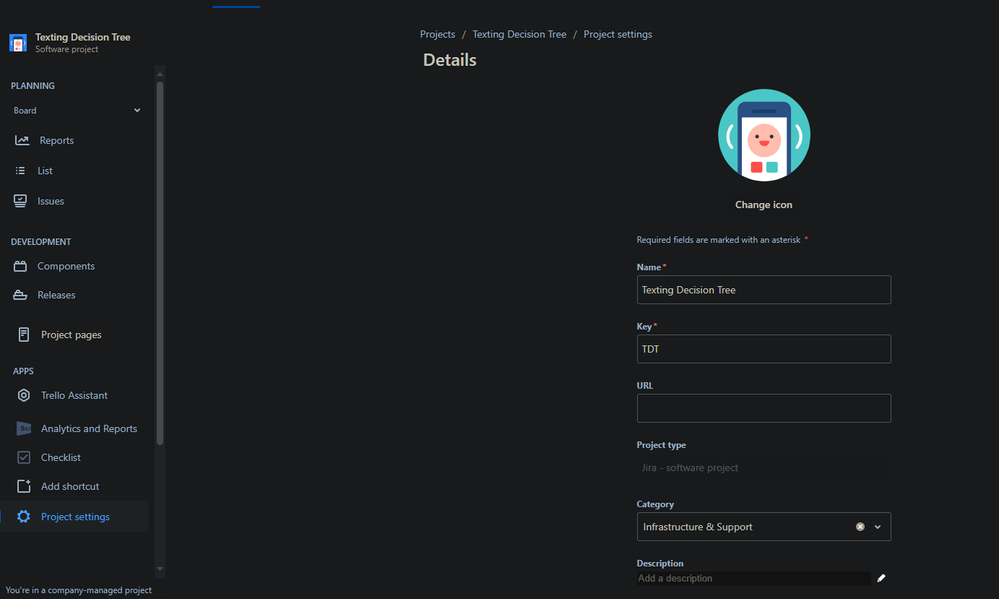

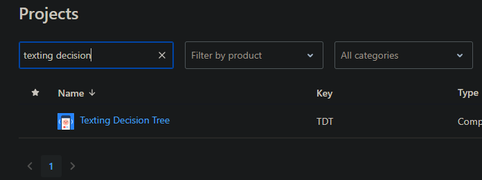

Have copy a project with 20 issues, and all seems fine from copy feature, but on destination there's nothing.
Did here a test with other projects and can see all the issues on destination but for this one, nothing.
Am I missing here something?

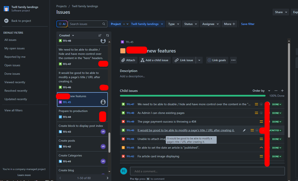

On source:

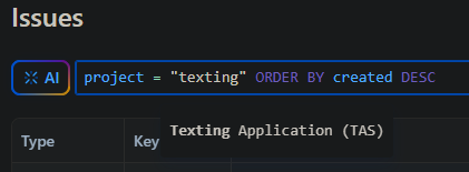

On destination:

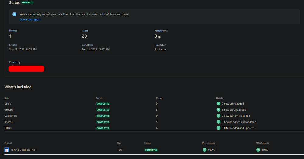

Migration status:

This project was at least created on destination, but there's no issues in it, even seeing that status on migration about 20 issues (that makes sense compared with source tenant):Screenshot_674.pngScreenshot_673.png

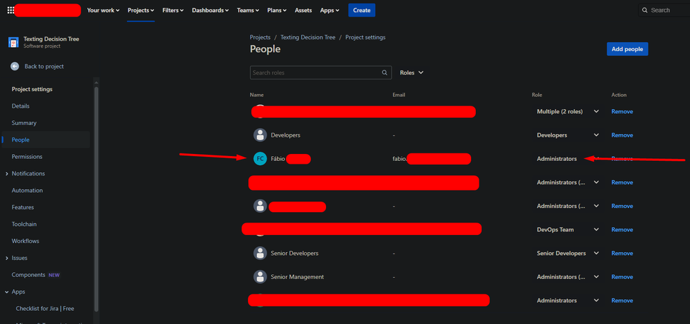

It is not because you're in the Administrator role that you have browse project permission in a project.
If the migration tool shows that all data was transferred correctly, it is most likely there. You should check the permissions tab under project settings and make sure that the Administrator role is indeed linked to the browse project permission.
marafado88
September 13, 2024
Ah ok, after adding administrators group into browse projects, I was finally able to see. thank you a lot Walter!
