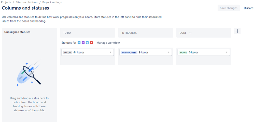

  • Board > Columns and statuses only shows TO DO, IN PROGRESS, and DONE columns. These are the three statuses of issues in this project. Within each column is a sample issue type that I think would have been in the Unassigned statuses column had it not been in the correct column.
I see no other settings that could possibly block all cards from appearing on this board.

What type of project are you using? Team-managed? Company-managed? Jira Work Management?
Also, can you include a screenshot of the Board Settings on the Columns tab?
Aren Cambre
October 28, 2022
Sorry that I left that out! It's a team-managed product per what's on bottom left of /jira/software/projects/[key]/settings/details.
Here's the requested screenshot:
