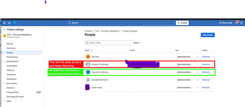

Juliette Bramall
June 24, 2025
The issue was with the user's account. She had been added to the project using her email address, rather than adding her Jira account. As soon as we added her correct user profile, she was able to create/edit components.

Juliette Bramall
June 25, 2025
Not quite. The user only had one Atlassian account, but her email address had been added as a project admin, rather than adding the user. If that makes sense. CPR.png

Staffan Redelius
June 25, 2025
Ok, I understand. It looks like the user in red is a Jira-Service Management-Customer. They are users that have access to the Customer portal but normally no access to Jira.
You can check that under Administrator ->Groups and see if you find her in the "Jira-Service Management-Customer" group

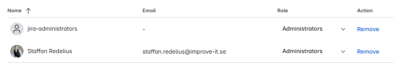

Hi @Juliette Bramall
To be able to manage components you need to be a Project administrator (or a Jira System administrator)
If you go to Project settings -> People are both users Administrators? Or is the role Administrator set to a group? In that case are both users members of the same group?
In the picture below I am personally added to the role "Administrator" (which is the Project administrator for the project) All users who are member of a specific group in this case "jira-administrators" are also Project administrators in this specific project based on their group membership.
Let me know if this is of any help!

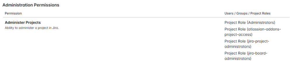

Juliette Bramall
June 24, 2025
Hello Arielei
The permission scheme is set for project role. I don't understand why one user can create components, the other cannot. Yet both have the same permissions. Screenshot 2025-06-24 112440.png

Juliette Bramall
June 24, 2025
Hi Alexander
They both have the role of Administrator in the project. And the permission scheme for the project give the Administrators the ability to administer projects.
Thanks
