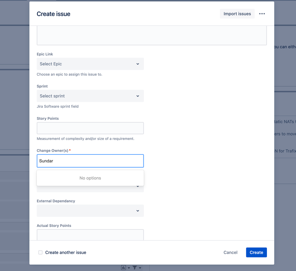

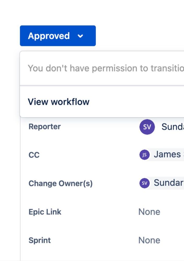

For the Owner Issue, here is an example of what the fields look like when creating a ticket:
Notice that the user can't even enter their own name as an owner, nor anyone elses.
The way the user has been getting around this, is that they have to take a pre-existing change/issue that another user created for them, in their name (Sundar).

I granted the transition role and now the user is able to set tickets to close! Our only issue now is to figure out the "owner" issue when creating tickets.

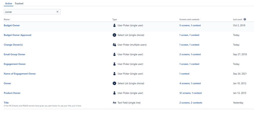

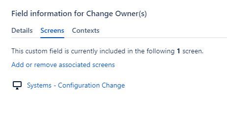

Hi Trudy,
I went ahead and found what looks to be the custom field that was created within the Issues pane.
I searched for "owner" and got the following:

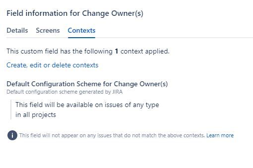

I then clicked on the "Change Owners" name and got the following:

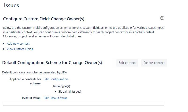

If I am to click on "Create, edit or delete contexts" from the "Contexts" options, it will showcase the following:
That is all useful information.

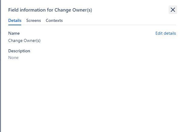

Can you check one more thing? In the Field Information pop-up that you got, can you click on the Details tab?

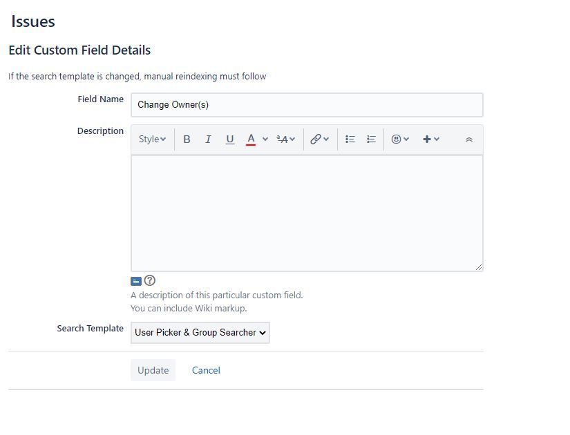

Hi Trudy,
If I'm to click on details, I see the following:
If I am to click on "edit details" on that page, I see the following:

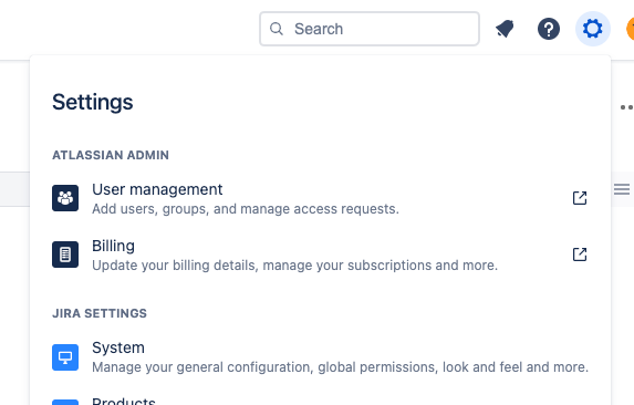

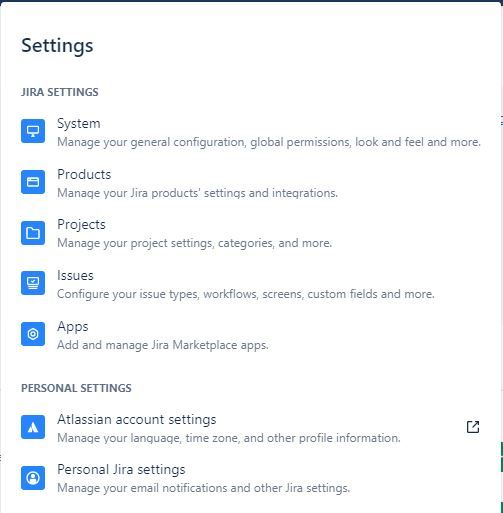

Hello @Superfreak
I do not know of a way to look in Jira itself as a Jira Admin to find out who has Site Admin or Organization Admin permissions.
When you click on the Gear icon, do you see these Atlassian Admin options?
If you do, that means you have either Site Admin access or Organization Admin access.
If you have that level of access, be very cautious about changing things unless you understand the ramifications of the changes!!
If you have the User Management option then that will give you sufficient access to create a new User Group, outside of AD, to which you could add the user and then add the group to the Global Permissions within Jira.
This is what my menu looks like if I'm to select the cog wheel. Looks like I may only have certain admin privileges.
It appears that you will have to try to find the Site and Organization administrators for your company. I would recommend talking to your IT organization to see if they can help identify those people.
