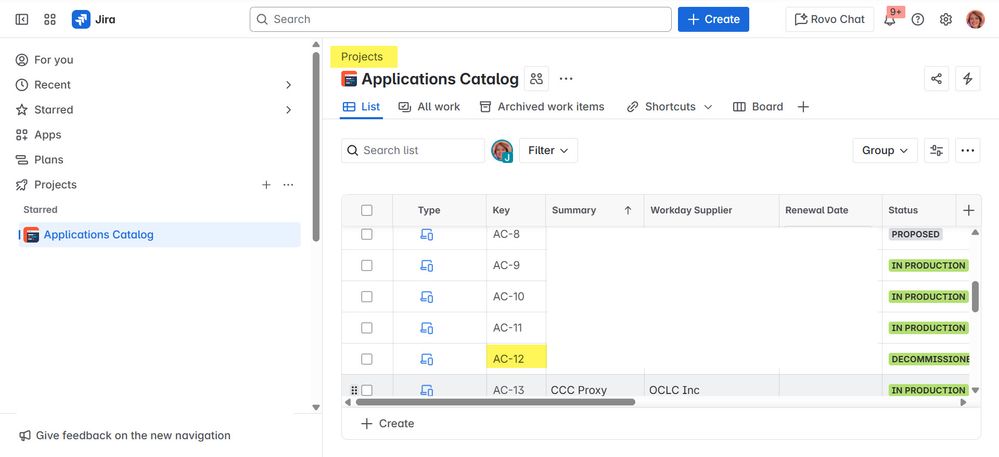

  • PROJECT VIEW displaying 3 statuses
    • Proposed (Strike-through  NO)
    • In Production (Strike-through  NO)
    • Decommissioned (Strike-through  NO)

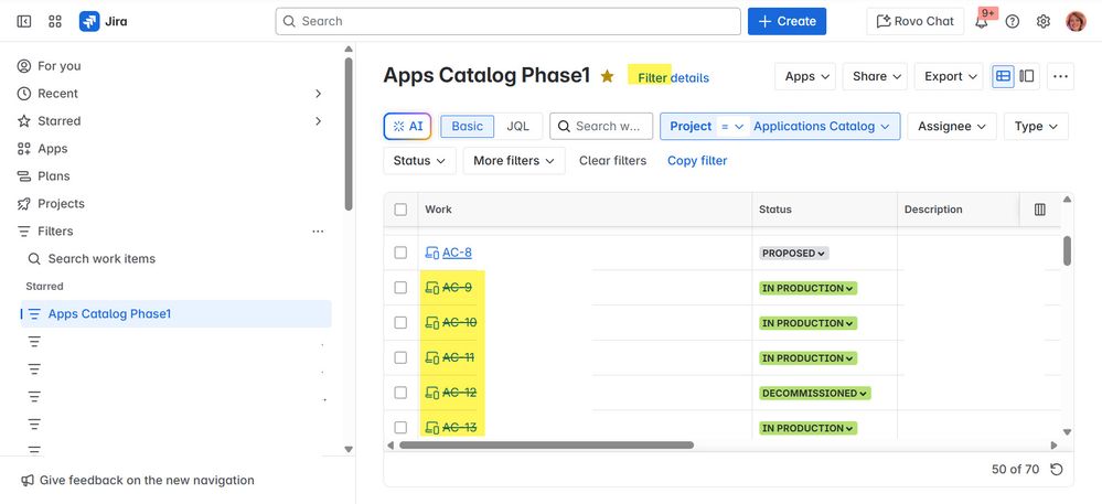

  • FILTER VIEW displaying 3 statuses
    • In Production (Strike-through  YES)
    • Decommissioned (Strike-through  YES)

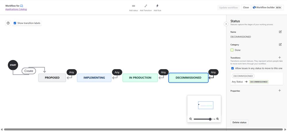

  • WORKFLOW

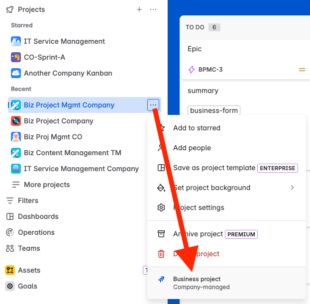

Can you tell us what type of project this is? You can get that information for the View All Projects page, or by clicking on the ... button next to the project name in the panel on the left.
Julia R.
August 14, 2025

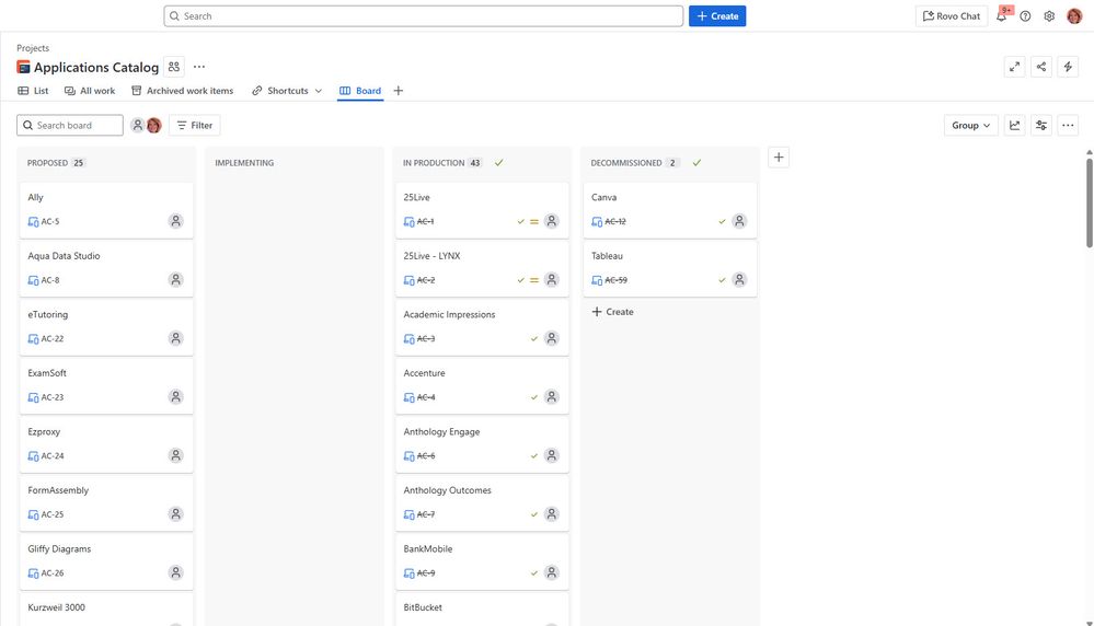

Ahh, That is interesting.
LIST View does not show strike-through but BOARD View does show them.
Thank you for sticking with me, @Trudy P Claspill

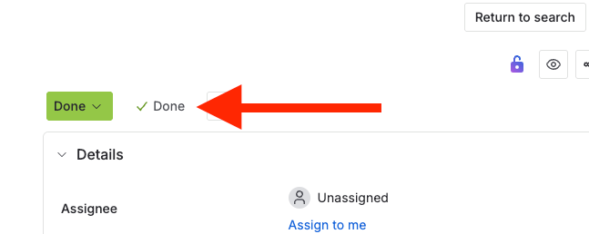

In the views that do show the strike through, that is shown because the Resolution field has been set on the issue.

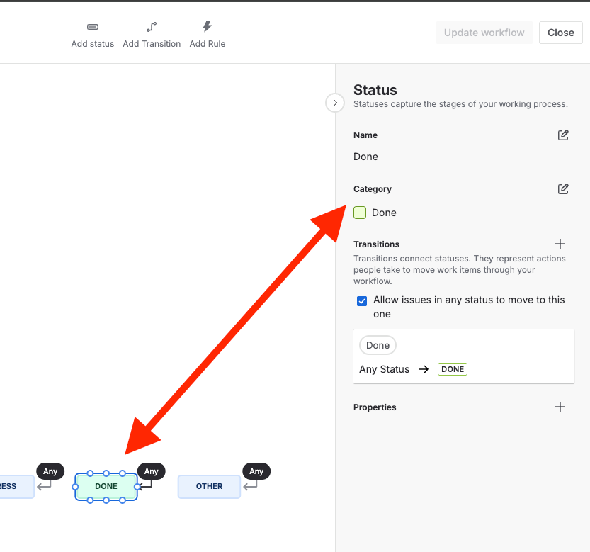

Trudy P Claspill
August 14, 2025
Sorry, clicked Reply by mistake. I wasn't done with my answer.
In a Team Managed project the Resolution field is set automatically when an issue is transitioned to a status that has been assigned to the Done status category, identified by showing as a Green colored lozenge like the Done button above. You can see this in the Workflow also.
The Resolution field is cleared automatically when the issue is transition to a non-green/done status.
You could change the Category of the In Production status to blue/In-Progress, and going forward issues changed to that status would not have their Resolution field set and would not show a strike through. That would not clear the Resolution field of the issues already in that status. To clear the field you would need to transitions the issue to another status and then back to In Production.
