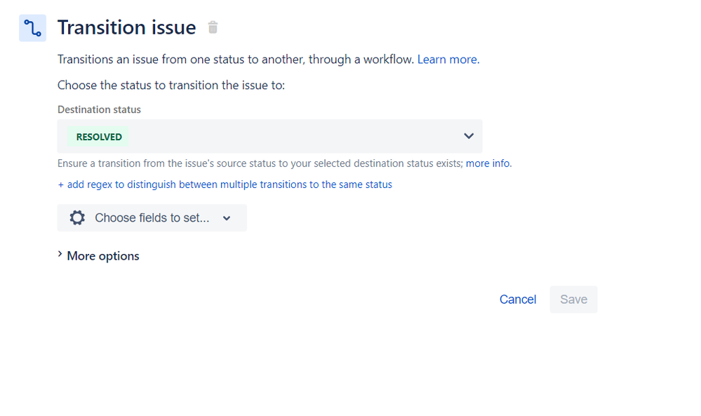

Project Automation if date is greater than today+5day transition to resolved
Robin Stemmers
October 11, 2020
Hi All
I hope you can help - Newbie to Jira Project Automation.
I want to auto resolve an issue based on a date +5 days .
If my date = 25 October 2020 then 5 days later it must transition to Resolved.
My Date is a custom field.
What is the condition I must use to complete the above action?
Can you provide me with the correct syntax.

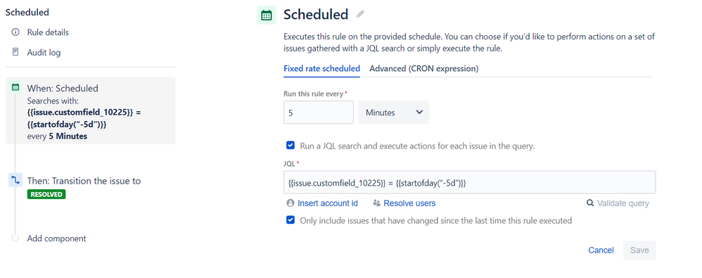

Jack Brickey
October 12, 2020
just getting back to this. You need to use the startofday(-5d) as a Condition not as part of the schedule. I think...

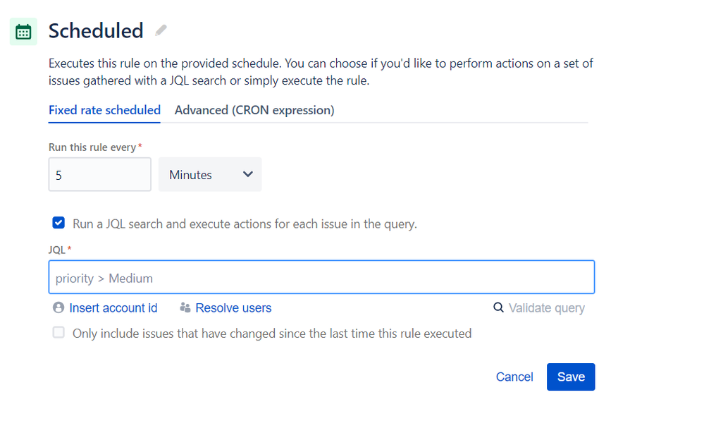

Robin Stemmers
October 13, 2020

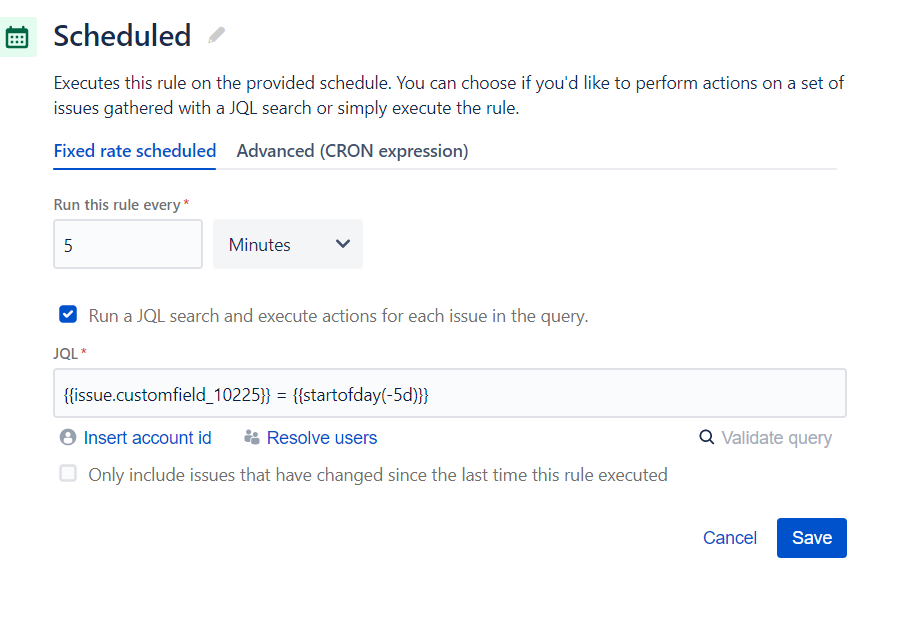

Hi - This is still not working for me - what am i doing wrong?
1_Scheduled.pngI have used that scheduled trigger and this is my JQL entry
{{issue.customfield_10225}} = {{startofday(-5d)}}

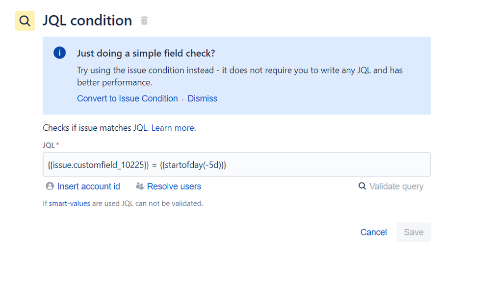

What error are you getting? Or what is the result of when it runs?  Can you share the audit log?
John Funk
October 13, 2020
And did you add the query as a condition as well?

Robin Stemmers
October 13, 2020
Hi
I just ran this now
Action details:
Scheduled
Error running query for scheduled JQL trigger:"('=') AND (project in (10210))" - Error in the JQL Query: Expecting operator but got ')'. The valid operators are '=', '!=', '<', '>', '<=', '>=', '~', '!~', 'IN', 'NOT IN', 'IS' and 'IS NOT'. (line 1, character 5)
Associated items:
None

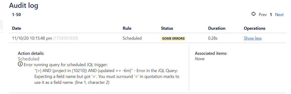

Robin Stemmers
October 13, 2020
Action details:
Scheduled
Error running query for scheduled JQL trigger:"(=) AND (project in (10210))" - Error in the JQL Query: Expecting a field name but got '='. You must surround '=' in quotation marks to use it as a field name. (line 1, character 2)

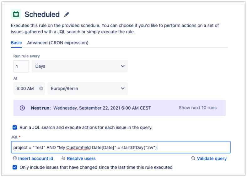

felix.weber
September 21, 2021
Hi @Robin Stemmers
 I guess this has already been solved - however as there is no finally answer and I faced a similar issue I solved it in this way (in my case I am checking for issues where my customfield date will match in 2 weeks ( be aware of the "=" this makes sure it matches exactly in 2 weeks)
my JQL is just a normal JQL not using directly a smartvalue:
project = "Test" AND "My Customfield Date[Date]" = startOfDay("2w")
