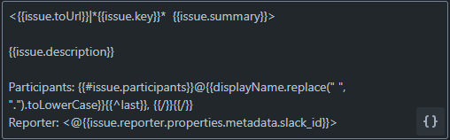

At the moment in the message what works fine is:
What doesn't work is mentionning all the participants. Using the following formula:
{{#issue.approvers}}@{{displayName.replace(" ", ".").toLowerCase}}{{^last}}, {{/}}{{/}}
I made some progress and 9 names across 27 are correctly mentionned when tagging them as participants. The others are not mentionned. I tried to use <@memberId> but i didn't understood where did i had to integrate this part ot the whole above.

Hi @Hippolyte Simon,
Slack no longer support @username so you have to use their member Id. Have a look at this article that describes how you can add users Slack member Id as properties on their accounts.
Hi thanks for your quick answer!
A friend of mine and I found the solution, since i use this method to link Jira and Slack: https://community.atlassian.com/t5/Automation-articles/Mention-someone-directly-in-Slack-via-Jira-Automation/ba-p/1528605
Here's the formula:
{{#issue.participants}}<@{{properties.metadata.slack_id}}>{{^last}}, {{/}}{{/}}
