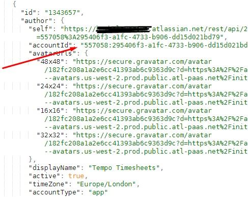

Now for the user's ID, if you look at the screenshot below, each history has a section which lists the user that made the change, so you can get it from there without doing anything else

Hi @Rashi Goyal
Sorry, I have no idea what email-id is - if you mean the email address of the user, that is no longer available because of GDPR concerns.
Also project manager is not a field that I'm aware of - if this is a customfield that you have added, then you will need to know the field number, because customfields are referenced in the API with the format customfield_12345. If it is one of your customfields, you should be able to find it in the JSON returned from your API call
Rashi Goyal
October 5, 2020
@Warren while using JIRA I think every user's e-mail address is linked.
So, don't we have any way out in API Calls to get the same?
If not the project manager then I think it is possible to get an assignee?
If yes please let me know
Warren
October 5, 2020
Hi @Rashi Goyal
No you are able to get the user's displayName, see my screenshot further up.
Yes the field assignee is available
