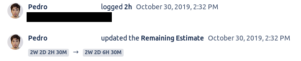

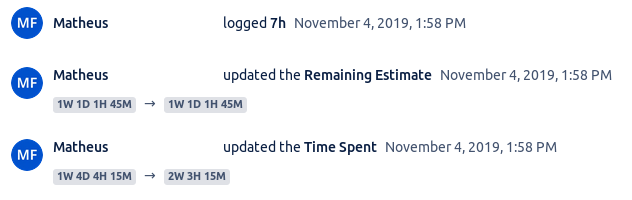

Hi! We've been using JIRA for a while and didn't have problems with it till recently. Sometimes we notice that JIRA has been miscalculating the remaining time estimate. It should decrease the time based on the time a member of the team has logged, but it has been subtracting wrong values. Sometimes JIRA does it and then the remaining time estimate becomes orange even when there's still time left based on the original estimate. We have two screenshots of the history tab that's attached here. Pay attention to the logged time and the time that was actually subtracted.
I'm not sure whether we're using JIRA wrongly or that's a bug. Has anyone ever had a problem like that?
Note: We use the new issue interface.
