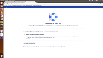

Problem with Jira 7.12: atlas-integration-test doesn't run tests and writes "Waiting for http://localhost:2990/jira to start" message infinity.
Details:
I develop a plugin for Jira.
Starting from Jira 7.12, atlas-run/atlas-debug/atlas-integration-test run Jira with the next warning on startup: "Your memory allocation pool settings need attention"
I can click "ignore all warnings and continue" during manual testing, but how can I suppress the warning, when I run tests with help of atlas-integration-test?

You should not ignore the warning, your Jira will rapidly run out of memory and halt if run with less than 384m
Irina Svirkina
September 26, 2018
I setup maven-jira-plugin with -Xms (see below). It helped.
