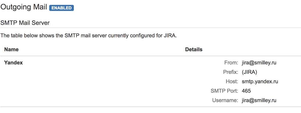

Screenshot at авг. 27 20-53-16.pngIt's set to be jira@smilley.ru, but in logs it's set to be an email of currently logged user...

As I said earlier, test emails are sent correctly.

But it was solved by  setting same data at  "From address" and "Username" fields.
