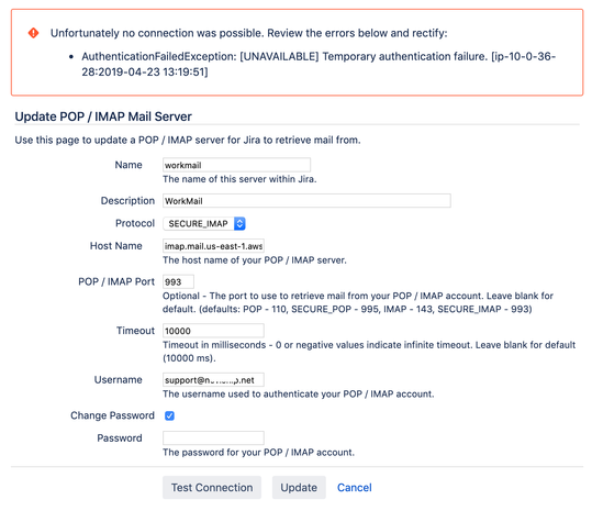

Now that AWS WorkMail provides an IMAP server, is it possible to use it for Jira's incoming mail reader?  I tried to configure it but get the message below:
Unfortunately no connection was possible. Review the errors below and rectify:
  • AuthenticationFailedException: [UNAVAILABLE] Temporary authentication failure. [v20190121t1047-197-imap-iad-prod8:2019-01-25 12:26:10]
I'm connecting to imap.mail.us-east-1.awsapps.com using SECURE_IMAP with the correct username and password.  I know it isn't credentials as I get the same error message when using the wrong username.
Is there a known incompatibility?

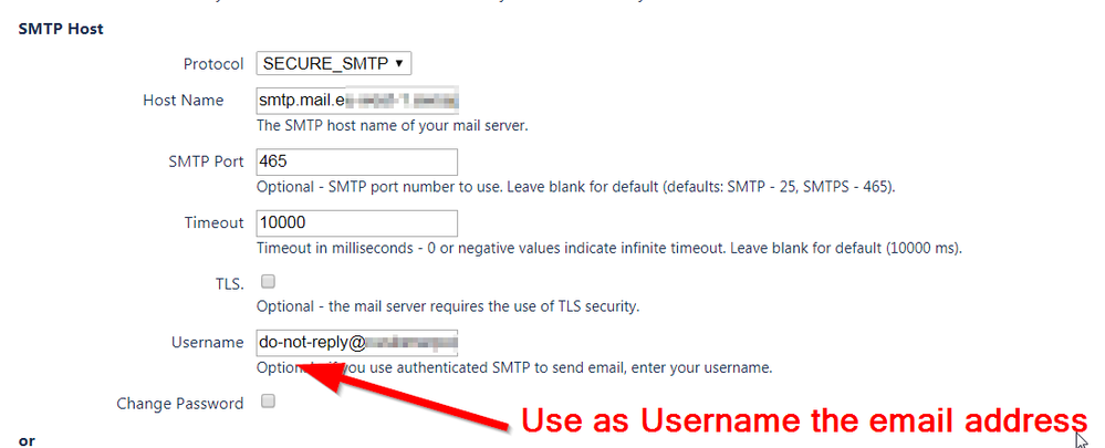

Hello, we had a similar problem.
Our mistake was that we had not taken the email address as username ^^
Regards,
Sven
epedder
April 23, 2019
Thanks for the advice.  I am definitely using the e-mail address as the username.  Note that your screen-shot is for configuring outgoing mail (with SMTP) and in my case that works fine.  I'm only having trouble with incoming mail (with IMAP).

I know your request is old, but this seems to be hit or miss. I have 3 other mailboxes configured exactly the way you are attempting. I am trying to configure the forth and I get:
Unfortunately, JIRA couldn't connect to the mail server. Here is what the mail server said: "[UNAVAILABLE] Temporary authentication failure. [ip-10-0-106-104:2019-04-19 21:38:22]" Che
I have reached out to my AWS domain expert and will keep you posted.
epedder
April 23, 2019
That's the same error I'm receiving.  Are the 3 other mailboxes that are working using AWS Workmail?  And yes if your domain export has any advice that would be great.
