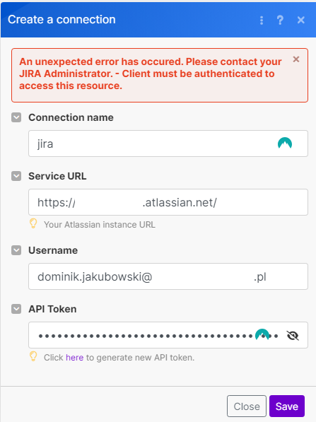

I have problem with connect Jira and make, when I put my mail, API token and site adress I recived error:
An unexpected error has occured. Please contact your JIRA Administrator. - {"status":{"status-code":[401],"message":["Client must be authenticated to access this resource."]}}
What can I check for this?

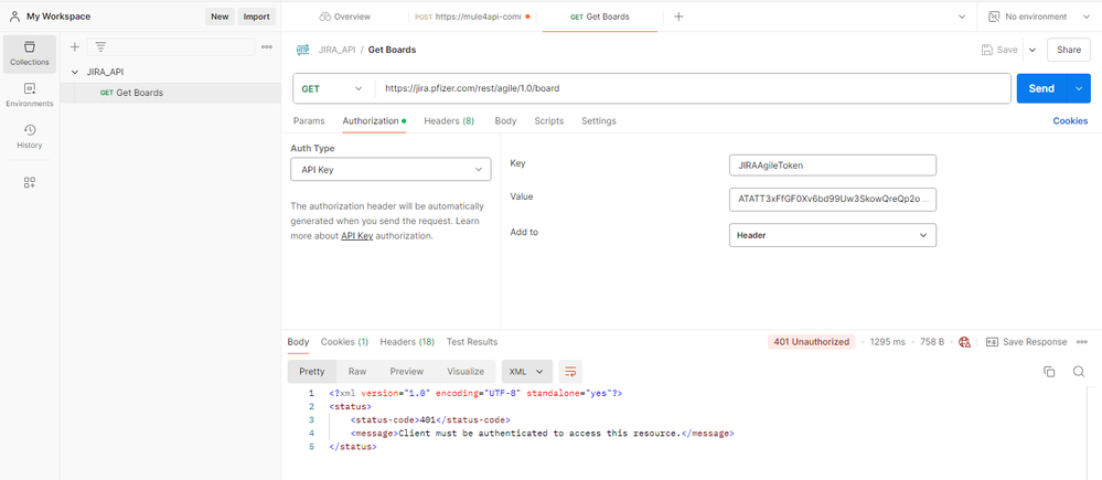

Hi - Have a similar issue and I have the security tokens as well and created a new token - however faced the same issue while checking for boards from postman.

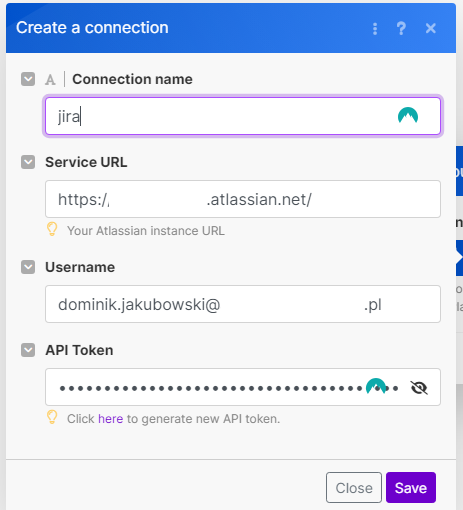

I wan to use make.com , this is tool for automate some funcition.
For first I have to config connection to jira
After save I recived error:

I've tested make.com and I can create a connection without any issues.
The problem you are having could be due to:
- You are not using a valid email address for your Atlassian.net site
- You don't have the right API token
Check that you have a token here:
https://id.atlassian.com/manage-profile/security/api-tokens
If not, create a new one.
Can you log in to your Atlassian site with dominik.jakuboski@ email account?
Regards
Like Daniel Prudente likes this
Daniel Prudente
September 10, 2025
I was having the exact same issue, thanks for the link! My issue was that I was creating an API key (admin.atlassian.com/..../api-keys) instead of an API token (id.atlassian.com/.../api-tokens).
Now it worked well.
