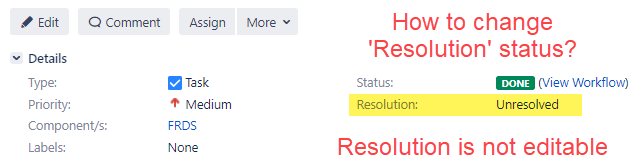

Once we get to 'Done', our issue stays 'open' because we can't figure out how to set 'Resolution' to either 'Resolved' or 'Fixed' and/or somehow get it off our "Open Issues" list.

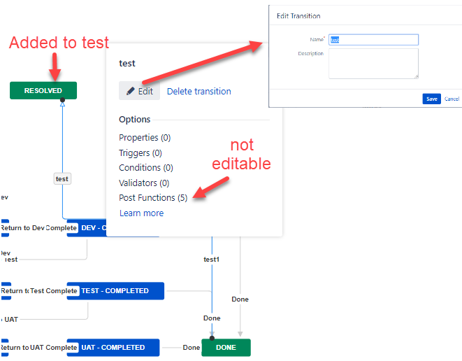

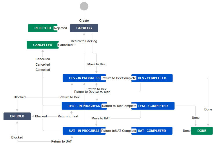

I've attached screenshots of our Issue Details, a test I did with adding a status 'Resolved' (which loops back to 'Done') and our workflow.

My guess is youi are using "Extended project administration" permissons which is why he could make limited edits to the workflow but not add post functions.
Yes, your workflow is currently broken. Generally you have to set resulotion when transition an issue to "done" This is usually done in 1 of 2 ways
1: A transition screen in the last transition that allows the user to set the field
2: A post function that sets the resolution to a static valule.
MY guess is you copied the workflow and them removed the transition screen, thinking you were making this easier, but not.
As to how to fix it. This gets a little tricky. Not much you can do without a full jira admins help.
  1. Adding resolution to the edit screen. This is generally a bad idea unless you take other steps. Resolution is a required field in the field connfiguration. Meaning if it appears on the screen it has to be filled in. If you put it on the edit screen, and someone edits a ticket that isnt closed, then they will have to set a resolution, which you dont want. So to be safe you need to first make the field optional, then add it to the edit screen. However You would need full jira admin rights.
     If you know no one will be working, you can try to add it to the edit screen, change all the tickets, and then remove it from the screen, Have to be careful that no one else is using jira
    So in general, I would not recommend this option.
  2. You need to fix the workflow anyway. So talk to your jira admin. Ask them the add a post function to set the resolution on any of the transitions that lead to done. While they are at it, ask them to add a transition that goes from done to done called "fix resolution" with a post function that sets the resolution, (and a validator that the resolution is empty if you want) You can then run that transition on any broken issue to fix it.

I am not sure why access to add Post condition is not available when you have permission to edit the transition.
You can try adding the field 'Resolution' to your screen when transitioning to the status 'Resolved' as a workaround

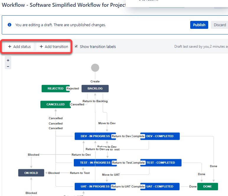

How do I add a field to the workflow?  My only options are to Add Status and Add Transition.  There is no "Add Field".  See screenshot below.  Thanks!

sukkeong
March 18, 2020
  1. Go to Administration > Issues > Screen
  2. Select the screen used in your transition, or create one if you don't have one.
  3. Select 'Configure'
  4. Add the field 'Resolution'
    • You can drag-drop the field order.
For more information, here is the link: https://confluence.atlassian.com/adminjiraserver/defining-a-screen-938847288.html
