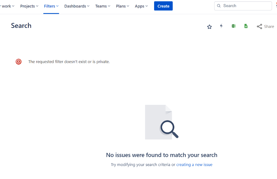

Thank you for the quick reply. When they try to access the filter - its throwing an error message as below:

@Sana SaraffAhh, So users are not able to access the filter so the dashboard as well, you need to check the filter permissions to give them access may be single user, group or project etc, make sure to click on add and later save to check the changes and re-verify it again to confirm permission changes are updated, sometime we not save it and cause this issue.
Like Sana Saraff likes this
Sana Saraff
October 24, 2023
Thanks @Ravina _ I have re-applied the permissions(had to do it a few times) and now I can see its all working fine.
