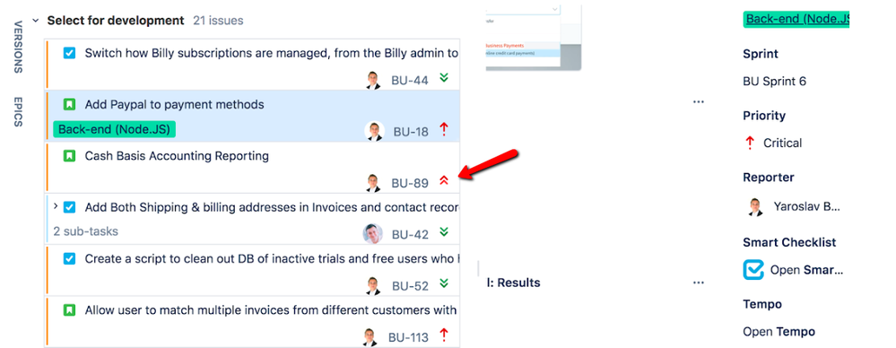

Hello Guys,
Our client wants to see a Priority flag on a Kanban board card, is it possible to customize the layout of the card so that to add the status. This is an example: 2018-09-13_1504.png

I'm Admin at this board. Andriy sent you the screen from Agile board how it should looks, we have Kanban Board and would like to have the same icons.

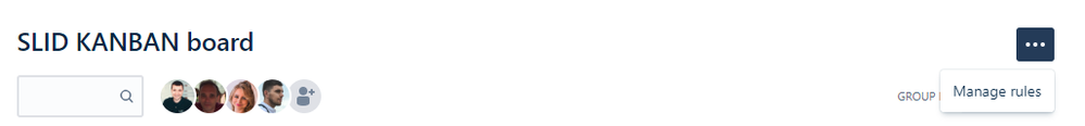

Now I also haven't this opportunity: http://prntscr.com/l26sgo
How we can add it there?

Are you or Andriy the admin of the Jira instance also? Because from you're screenshot i understand you have chosen the 'Agility' project template.
Here you have less options. It's better to change the project to the kanban template (you can request this to the admin). Then you will have all the options to customise you're board.
