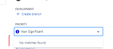

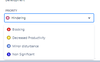

When an issue is set to Priority 'Non Significant' (lowest priority), it is not possible to change to another priority. The Priority-dropdown (that usually lists all priorities) says 'No matches found'.
When using bulk change functionality I can perform the change of priority, but not from the issue view. (See screenshot of Priority dropdown).
Any idea if this is a configuration gone wrong or a bug i JIRA?

But again, priority scheme do not exist in Cloud solution, so I cannot use that workaround.
I tried changing back to the old 'Issue View' using my personal settings (under Jira Labs section).
This solves the problem.
Thank you for you inputs, I will report this problem concerning the new ISsue View to Atlassian to be sure.
