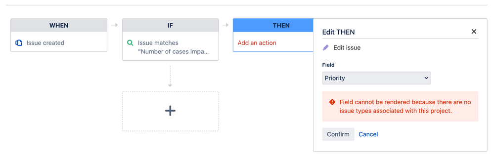

Isn't it possible to determine and set Priority based on a custom field during issue creation ? Like if number of cases are more than 50, set priority as "Major" or something ?

Hi @Davis Chettupuzha
This is the legacy automation.  I would use the new jira automation:

Will try using smart values. But think issue here might be related to field not available during jira creation.
The problem may be the field is not present on the issue create screen!! Can you try adding the field and then configuring Automation.
Or re-indexing would also fix the issues sometimes.
Let me know if the issue resolves by trying above two methods

I see you are using legacy Automation, can you try with new Automation for Jira!! @Davis Chettupuzha

How do I get new Automation ? Is that on a different jira version ?
Pramodh M
January 27, 2022
@Davis Chettupuzha
Its Cloud, Navigate to Settings, you'll have the option and follow @Fabian Lim guide to set the automation.
