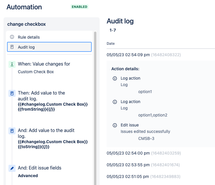

If you are using the Field Value Changed trigger then you can use the {{changelog}} smart value to reference the changed field To and From values.
In this example I am printing the values in the Audit Log for the rule.
To set a checkbox field you have to use the Advanced Editing with JSON option.
https://support.atlassian.com/cloud-automation/docs/advanced-field-editing-using-json/#Checkbox-custom-field
What makes this more complicated is that I assume you will have a variable number of checkboxes checked. You would need to be able to parse the fromString to find the names of each check box that was selected, and then find a way to set each of those check boxes. I don't know if conditional logic can be implemented in the JSON to deal with the results. I've never researched if that is possible or how to do it.

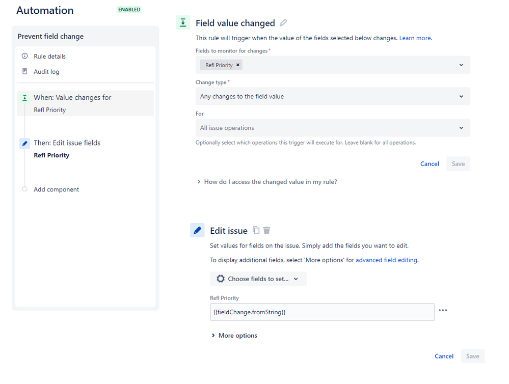

Hi, thanks for looking into this. Here is an example of a working rule, operating on a field of type "number". This was constructed by looking at various examples/posts elsewhere.
If I change the rule to operate on a field of type "checkbox" (something with multiple items that can individually be checked on/off), then the rule no longer works. I've also tried using {{fieldChange.from}} which should evaluate to the raw data type...this doesn't work either.
Are you familiar with the API/language in use here? What does {{blah}} mean? What kind of expression is expected for the "edit issue - set field" input? Is this supposed to be a string? If so, why would {{fieldChange.fromString}} be accepted for some data types, but not for others?

When setting field values in the Edit Issue action the system expects you to provide an explicit value or an expression that equates to a valid input value for the field.
I don't know the language behind the interpretation of the expressions that can be used.
{{blah}} in this context is what Jira refers to as a Smart Value. It can be a reference to a field in an issue, a data structure, a calculation,.... There are a lot of ways smart values can be used.
{{fieldChange.fromString}} would be accepted for when the content of fromString represents a value that is a valid value to assign to the field. In the case of a checkbox field, if fromString contained multiple values they would appear as a comma separated list. When attempting to assign a value to a checkbox field through the Edit Issue action, a comma separated list is not a valid method for assigning the values. Values for a checkbox field can be assigned only through Advanced Editing with JSON.
