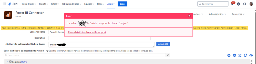

this erros occurs when I am trying to setup my Connector for the first time to get the connector url. Please refer to the following screen shot.

aio.jira.connector.exception.InvalidJQLException: La valeur 'XXXX' n'existe pas pour le champ 'project'.

It looks like your organisation has restricted the access of the connector to specific projects. It could be the reason why you get an error when the connector is trying to validate the JQL query.
- Are you be able to generate a connector, without using a JQL query?
- Can you get in touch with your Jira administrator to know which projects are restricted?
