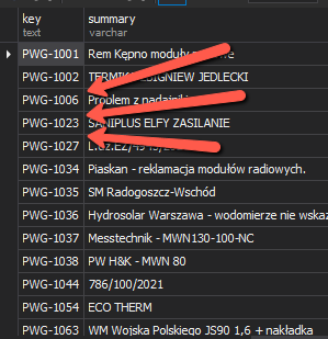

I know that is more db postgresql question, but I can't find solution on web. I create report view for customer, but there is missing issues (rows), becouse there is none rows in customfieldvalue table.

Guys, thank you a lot that you found piece of time to dive into my problem. The case is very easy, my customer wants to connect to db view to show this data in other system like Grafana. Some pie chart, and so on. This query contains simple joins with main table jiraissue. But the problem is in the custom field tables. I mean customfieldvalue, customfield and customfieldoption. Some custom fields are not obligatory, so there is no row in customfieldvalue table, and the result is that full row is not available in this view.
