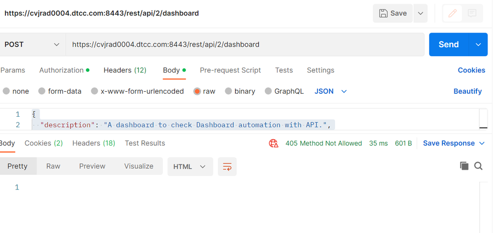

I Have used create filter API before it was working fine.
But when i try Create Dashboard API I am facing 405 issue

The 405 is not allowed
There are no defined POST options for /rest/api/2/dashboard in the server API documentation.
see
https://developer.atlassian.com/server/jira/platform/rest-apis/
(There is an experimental option to create a dahsboard on cloud but not server)

Hi @Logeshwari
That is the cloud api reference details.
It looks like your testing URL is a server cvjrad0004.dtcc.com .
Is that correct? If so it won't be available there. Cloud and server are the same product but essentially very differently built and not all features are available on both.
