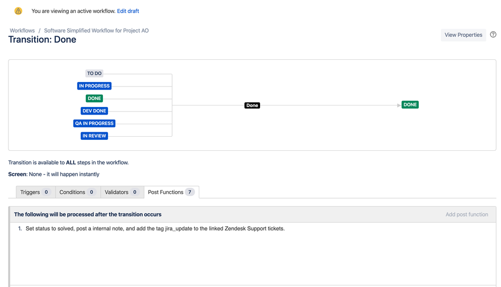

Justin Burger
January 6, 2020
We allow transitions from any status to any other status. I clicked the "Done' transition, see this screen, define the port function. If I do this with ANY other transition it works.. it's just "Done" that does not.
Nic Brough -Adaptavist-
January 6, 2020
Ok, that's clear.  I'm afraid to debug this, there are only two things we can do
  • Look at Zendesk to see what it is getting from Jira and work out why it is not updating
  • Read the Jira logs to find out what errors are occurring or being returned by Zendesk.  We can't do this ourselves, only Atlassian support have access to them.
I think you'll need to check to see what you can find in Zendesk, and if that does not help, raise a support request with Atlassian to get them to read the logs.  Https://
