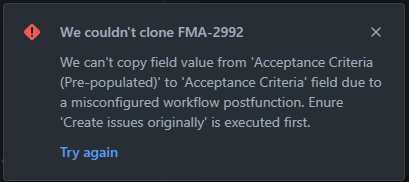

When I try to use the built-in Clone function (off the three dots), it fails saying I have to execute the post function "create issues originally" first. But doing that breaks the functionality during the Create process.

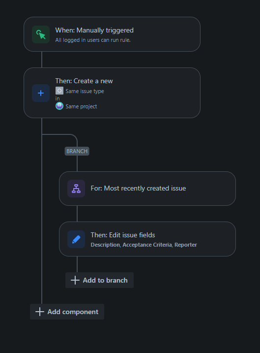

I then tried to build a triggered automation copying the description and acceptance criteria fields from the trigger story, but those two fields always come across with the boilerplate preformatted text only. I think I am in some crazy situation where I would need to copy the trigger story Description and Acceptance criteria fields to the cloned preformatted custom fields and then the creation workflow would do the magic of moving that content correctly.

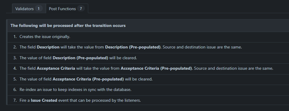

The Create Issue transition in any workflow comes with these three post-functions:
  1. Creates the issue originally.
  2. Re-index an issue to keep indexes in sync with the database.
  3. Fire a Issue Created event that can be processed by the listeners.
Any post-function you create in the workflow should ideally be placed below the "Creates the issue originally" post-function.
It still works correctly during the creation process.
The error, I previously incurred during the built-in cloning no longer appears.
However, the cloned issue doesn't show the description and acceptance criteria from the source story, but the boilerplate of a brand new story. I assume that is because it pulls the pre-populated versions into the cloned story after the creation of the clone.

BTW - While I would prefer to use the built-in clone functionality, as a workaround, I figured out a way to perform the clone with automation.
