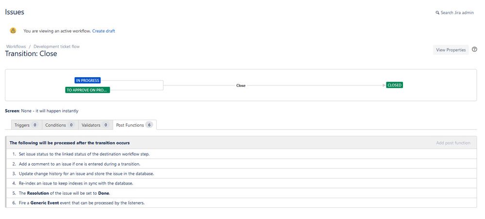

Hi,
For my close transition I used following post function: "The Resolution of the issue will be set to Done. "
This doesn't work as the issues are still on resolution: unresolved when the 'close' transition is executed.
Can someone tell me what I'm doing wrong?
Michael Andolfatto
May 7, 2019
Hi @Leyla Maya ,
The order in which the events fire is the problem. The resolution is being set after the database has been updated. You should move Step 5 to the beginning of the list.

Hi @Michael Andolfatto
Thanks for the reply but it still doesn't change the resolutions of my closed issues to Done.
Do you have an idea what the problem can be?
Thanks!
Michael Andolfatto
May 7, 2019
Just to verify- this will affect issues when this transition is fired going forward, existing issues will need to run this transition again. Have you published the workflow changes?
Leyla Maya
May 7, 2019
If I understand well, the resolution of existing closed issues will not change then?
Only issues that will be closed after I have done the changes on the post functions will receive the resolution: done automatically?
I have published the workflow changes
Raynard Rhodes
May 7, 2019
It is not retroactive. You will need to transition each issue you wish to have the updated resolution
Like Leyla Maya likes this
Michael Andolfatto
May 7, 2019
That's correct.
For existing issues, you can either add a temporary transition to take you from Closed back to In Progress so that they can run the updated close transition and trigger the resolution, or you can temporarily add resolution to the edit screen for these issues and manually set it.

Raynard Rhodes
May 7, 2019
Try moving the option above re-indexing
