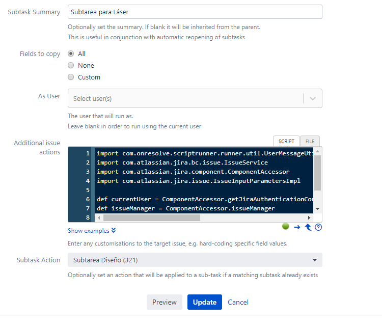

Also when I create the subtask I configured the transition as a Subtask Action and it doesn't work neither:

(321 Transition is("Subtarea Diseño") from "DPTO. INFORMÁTICA" status to "PROCESANDO DISEÑO" status)

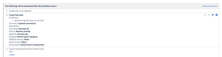

I went ahead and implemented this and was able to get it to work
1.PNGThese were added to the parent issues workflow. The script post function has the code below

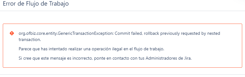

Finally I could succes with the transition, and I state my last problem here maybe you can help. If I configure a Condition in the transition to be hidden for the users view then I got Error on the transition due to forbidden action, but If I delete the Condition of hidden transition then it works perfectly, I put the error here:ç
Translation: It seems you tried to do a ilegal action in the workflow. If you think this message is incorrect contact Administrators,
