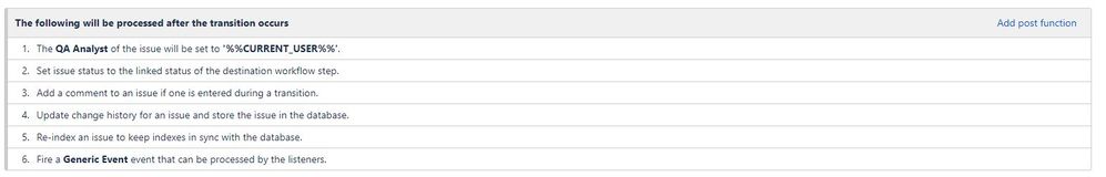

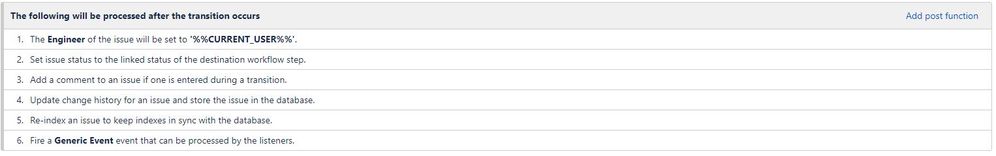

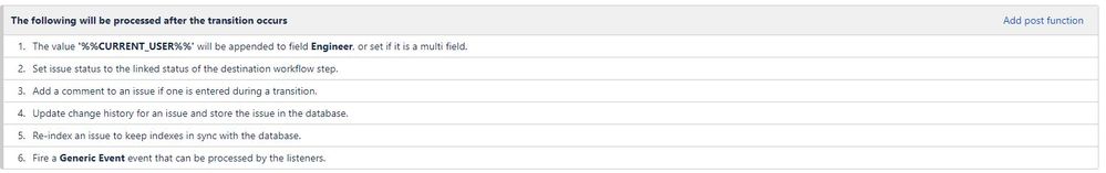

Screenshots of both Transition Post Functions I have in place:
No error. It just does not populate the field with any value. I can also confirm there is not transition setting related to the assignee. I read that if you have transitions limited to assignee it may not work, but that is not the case here.

@Grayson_Pollock  Can you try removing single quotes from %%CURRENT_USER%% and then see it if works?
John Funk
March 20, 2019
Great catch, Taranjeet!
Grayson_Pollock
March 20, 2019
@Taranjeet Singh That did it. This was a frustrating one since I copied and pasted the information from Atlassian's note at the bottom of the page with quotes, but now makes sense what they were doing. Really appreciate your help.

@Taranjeet Singh I prefer to leave the Assignee field out of the equation. Simply would like to stamp the Custom fields with the Current User when the transition takes place. Each of the Custom Fields is set to 'User Picker (single user). I made sure to publish the pages as well.
Below is a screenshot of the post-functions in place. I only added the top one, the other were already there. Appreciate your quick responses.
