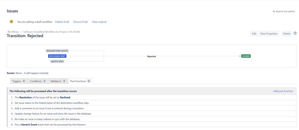

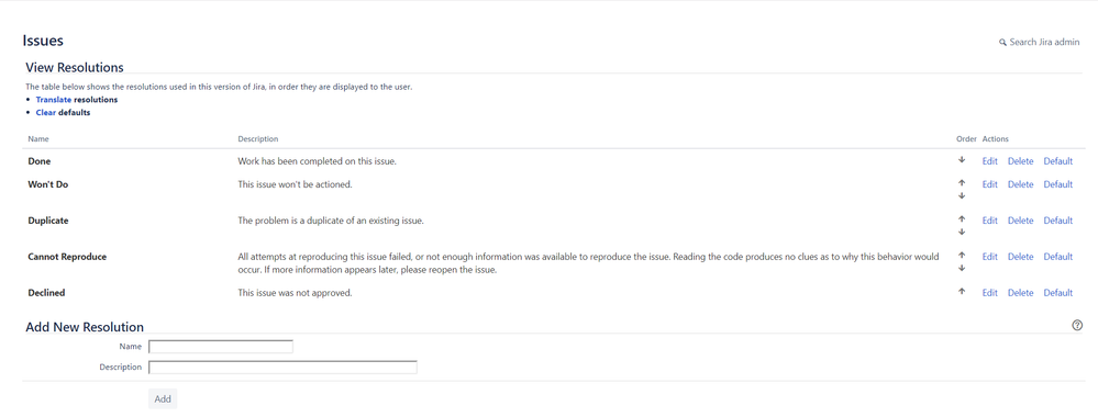

Did anyone find a solution to this? It's working fine for one my projects, but I'm setting up a new project and I cannot get the resolution to set.
I put it at the top of the post function list (1st picture), verified that the resolution of "Declined" is correctly configured as a resolution (2nd picture), I even tried having the resolution set to the default "Done" but it still did not work (3rd picture).
I've tried everything I can think of and everything I've found on Google - to no avail. Any suggestions are appreciated! Thanks2019-10-02_9-38-27.png2019-10-02_9-42-39.png2019-10-02_9-43-04.png

@Nic Brough -Adaptavist- The screenshots I provided are from the project I am working with, where the resolution still won't set. To my understanding, the post-function to set a resolution does fall before the functions to change history, index, etc.
Are you suggesting I create a brand-new post since the issues are not the same?
