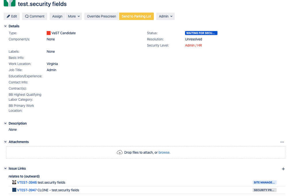

I am in a tricky situation in my Jira project that I'm not sure how to solve. The transition that occurred in the attached screenshot Test.1 just created the linked Issue called VTEST-3947 CLONE - test.security fields (blue box).
Meanwhile, the current Issue in screenshot Test.1 was already linked with Issue VTEST-3946 test.security fields via a previous transition.
What I want to do here is find a post function that will automatically create an Issue link between VTEST-3947 CLONE - test.security fields and VTEST-3946 test.security fields. Both are linked with the current test.security fields Issue, but they are not linked to each other.

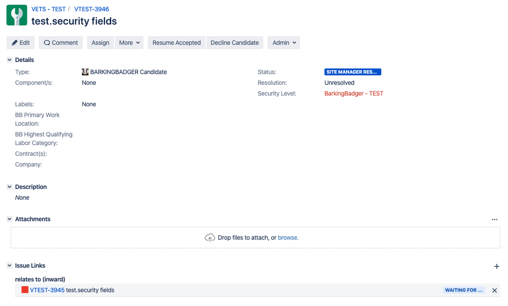

The attached screenshot Test.2 shows when on the profile page for VTEST-3946 test.security fields how it is not linked with the VTEST-3947 CLONE - test.security fields Issue.

Apologies for the lack of clarity in my initial post. I am using the Create / Clone issue(s) (JMWE add-on) post function to create the linked Issue on this transition.
The idea is to get the 2 Issues I mentioned, VTEST-3947 CLONE - test.security fields and VTEST-3946 test.security fields linked to each other as soon as the VTEST-3947 CLONE - test.security fields gets created and linked to the original Issue via the post function I mentioned in the top paragraph.
For more context - The ultimate goal I want to achieve is for the user assigned to the VTEST-3946 test.security fields Issue to be able to easily see what status the VTEST-3947 CLONE - test.security fields Issue is on. Because there is no link between the 2 Issues that information is not readily available. The idea is that the user I mention does not ever have an action for 3947 CLONE - test.security fields Issues, but knowing the status of that Issue is important for the project.
The link type I am trying to achieve is VTEST-3947 CLONE - test.security fields  relates to (outward) VTEST-3947 CLONE - test.security fields.
