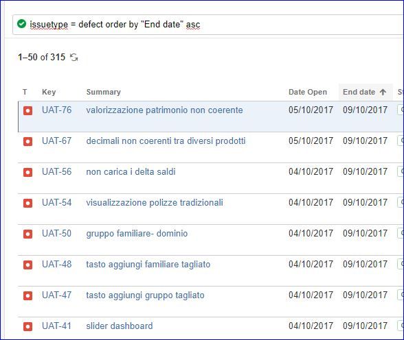

Hello,

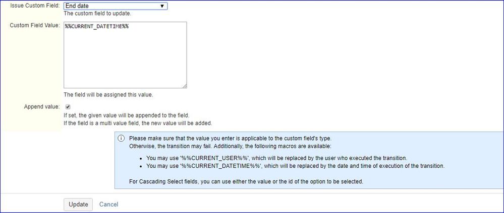

i've another problem on Jira. Follow the details
  1. I have  custom Field (type date pik) called "END DATE"
  2. I have a post transition on my workflow (when is the final status the custom field previously descriveb will be updated;
  3. In the post function UPDATE CUSTOM FILED i've inserted %CURRENT_DATETIME%% as suggest by Jira/Add-on
  4. The field is correctly updated with the date of transition

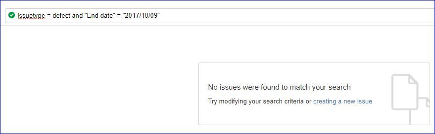

Problem
When i try to a query on this field, the query response me always with Zero Element. The problem is that the date is not saved correctly.
Could you help me? I insert e picture for help me in the analisys.

What result you get when you use
"End Date" > "2017/10/09" and "End Date" < "2017/10/10"
it seems like an issue with "=" operator.
Try to export the result and verify what value is saved in the End Date field . Does it store the date and time value. If yes , this is the issue

you are right, i've the result. The reason is in the date is present not only date but hh mm : ss
Ex 09/10/2017  12:39:00

Now i'm using  %%CURRENT_DATE TIME%% function, Exist Current_Date for istance?

Or have you tried %%CURRENT_DATE%%
