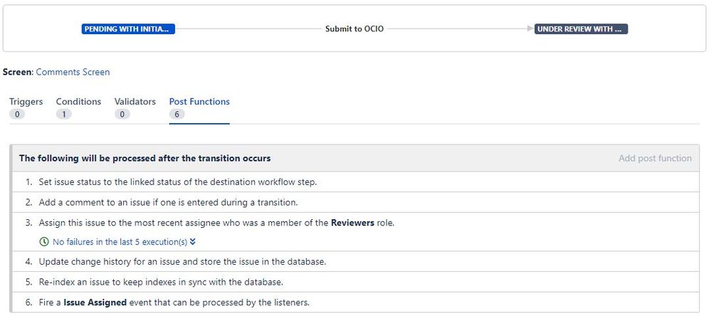

@Pranita Warik - Can you attach the screenshot of the postfunction of the "Resubmit" transition? Also ensure if the reporter has "assign issue" permissions.
Pranita Warik
October 1, 2020
@Niranjan
Added the post function.

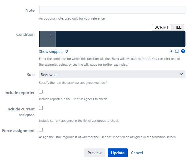

That was a suspicion. If a user makes a transition, reassigning post-function would happen as that user who has made the transition and to allow that, the user would need assign issue permissions. BTW can you also attach the screenshot of that particular post-function configuration. (settings of that postfunction)
Pranita Warik
October 1, 2020
Niranjan
October 1, 2020
@Pranita Warik - post-function looks good to me. What condition do you have for the transition?
Pranita Warik
October 1, 2020
@Niranjan
Only the reporter of the issue can execute this transition.
Niranjan
October 1, 2020
@Pranita Warik  Can you try to place the postfunction as the first postfunction? Just reorder the postfunction and put it on top? If that does not work, check the logs when the transition is made
