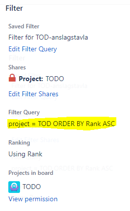

It seams like the filter exists in the Kanban board settings general section looking something like what is shown in the attached image below. I highlighted what seems to be the filter applied to the current project Kanban board. In the "Edit Filter Query" link I seem to reach a view where I can alter the query and indeed it works with the query you suggested when I execute it in this view. The result shows issues from both projects. However once I have done this I see no options in this view how I can apply the filter it to the current project. I can choose to save the query but it does not change the high lighted yellow query below once I go back to the view. When I do save as with another name I have no clue where it appears since I can't find it any longer. I can also see in the project Kanban that it's still only issues from the TODO project and not the other one I wrote in the query.

No, I meant create a new board / edit an existing board, NOT project. To work with the board you show (which is only including project TOD at the moment), click on Edit Filter Query which will allow you to add other projects as per my example.

The picture looks the same as before, with the yellow highlight showing only one project
