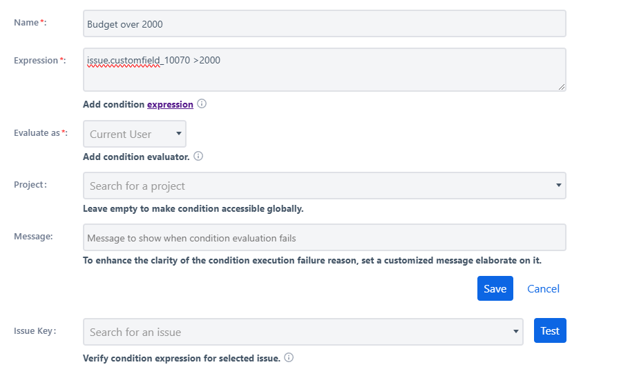

To show the solution on an example - here I created a custom field for budget (with ID = 10070), so the condition looks like this:

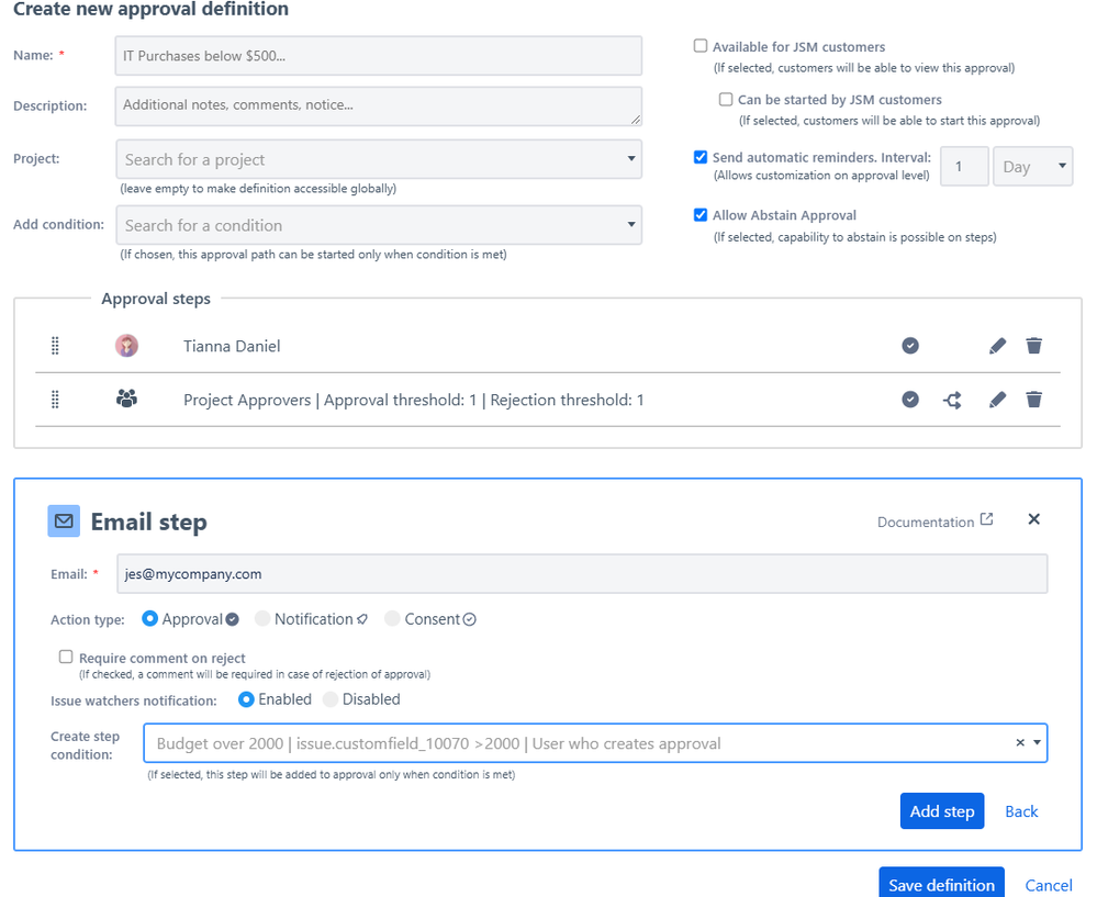

and the whole approval definition can be:
I hope it helps ;) The app I'm using is Approval Path for Jira, which allows approvals not only for JSM (you can check it out here ).
