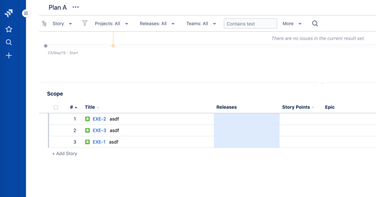

As an exe the only way I can get a discrepancy between the two plans ranks is if there are Uncommitted changes on Plan B after committing changes to Plan A like this:
Plan A Committed changes to rank from 2, 1, 3 to 2,3,1
Plan B Uncommitted changes of a rank order change from 2, 1, 3 to 1, 2, 3:
If I commit Plan B, Plan A will show the re-rank to match and if I discard changes on Plan B it will also line up the rank with Plan A.
