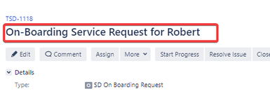

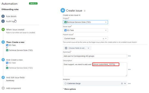

The way I test it for instance is that I have a service desk request when I need to create a new account for a user.
When the request is created , it create 2 sub task attached to the TSD request.
using automation I set the description field of the fisrt task by getting the user name using smart value syntax
In the mean time I add an Edit issue field function to edit the summary field of the issue which will add the user name in the same way

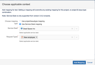

And to set field defaults in service desk, you need to create behaviour with mapping to service desk like this
Then click on fields and Create Initialiser with code like this
getFieldById("summary").setFormValue("New Employee")
This is will fill summary field with "New Employee" value and your user will not need to fill this field.
After this you can use @Gezim Shehu [Communardo] postfunction to add usernames to summary field.

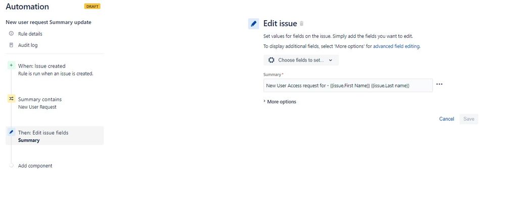

I wanted to update the summary field with the fields "first name" + "last name"
this is the script I ran in automation
"New User Access request for - {{issue.First Name}} {{issue.Last name}}"
Works a treat:)
