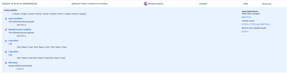

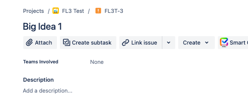

Christopher Atkinson
March 21, 2024
Here is the audit log... and the field inside the ticket....
Ste Wright
March 21, 2024
The second Log Action looks incorrect, {{TeamList.split("; ").distinct.join(",")}} should change the list...
  • From: Team 4; Team 5; Team 3...
  • Into: Team 4,Team 5,Team 3
Can you send a screenshot of the two Variable creation actions?
Ste

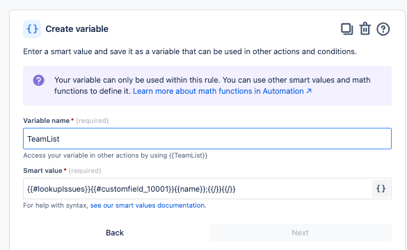

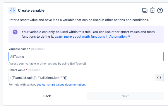

Ste Wright
March 21, 2024
Hi @Christopher Atkinson
I'm not saying it is this, but there's a space missing in the second one, with the smart value I used being {{#lookupIssues}}{{#customfield_10001}}{{name}}; {{/}}{{/}}
There's a space after the - but, I removed the space in my rule and the rule continued to work correctly.
Perhaps provide a screenshot of your whole rule, with the right-hand side visualising the "Edit Issue Fields" option in the Parent field.
A lot of checks I know, but I know this can work as I have it running on one of my instances :)
Ste
