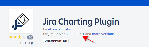

I was all excited until I read that it wasn't compatible with JIRA 8.2. We just upgraded recently or I would be all over it.
I believe that comment is outdated since the app is compatible with latest Jira version as shown here:
Bless you for noticing what I didn't! I'm going to give it a try.
